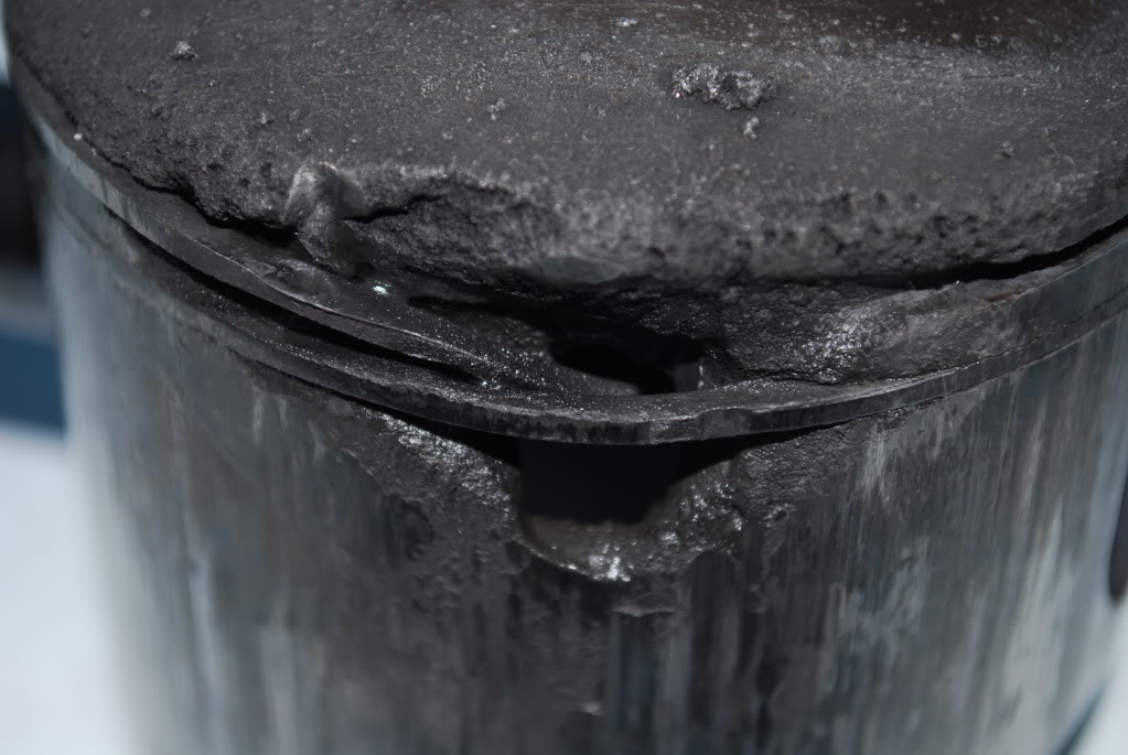

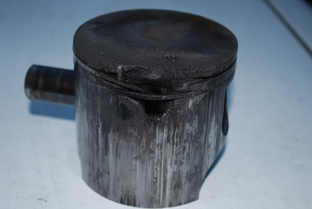

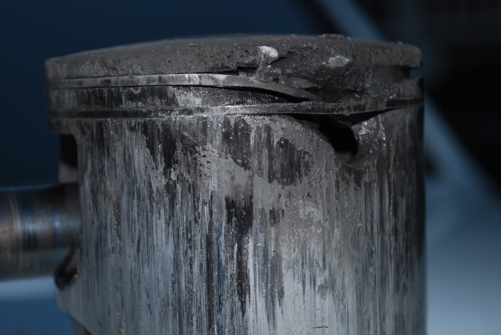

This is the magside piston from my ski,and why grey fuel lines should always be replaced.Not after one more run.Ski is a 98 GTX LTD.
I got home to the ramp like this from about 6 miles away.(ski was still running)Little bit slow though
Ski got a heart transplant since then.Just thought it would be good to show why the grey lines have to be replaced.It get's a lot of attention with a photo
