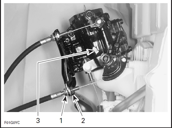

I finally found a couple of different manuals for my 1998 Sportster 1800 and I have just rebuilt the carbs but in the process of taking them off I noticed that the bottom cables on each carb didn't look correct. One wasn't hooked up and the of the other one was but I don't think it was correct. I don't know why there are three cables going to each carb. I'm assuming one is for primary, another is for secondary, and the third is for the accelerator pump maybe.
I want to hook it up correctly but none of my manuals show me a good view of all three connected. I can read everything about adjusting but I don't see any good pics or views of what I need.
Throttle cable, choke cable, oil pump cable. The service manual should show the hook up, you can get one if you join as a premium member or just google for a manual.

It's pretty simple on your boat, let me see if I can find a routing diagram for you to show the cable locations in the bracket.
On Edit:
This should help you with where it all attaches

I would have taken a pic but the bottom cable was not hooked up or didn't appear to be hooked up correctly and possible missing parts, which is the reason I would like a pic.
I sent that directly to you, anyone else having an issue seeing that I may have to change something on photobucket.
I see it now. I couldn't see it on the phone, but I can see it on the computer. I finally did find it in the manual, I guess I was looking to fast.
