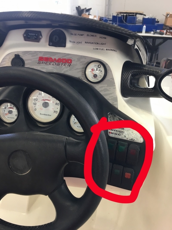

Turning my attention to my "dashboard" area.. It's in need of some pretty serious help.
Looks like someone has added an after market hour usage meter? (Crooked of course) so, not sure what to do about that. I HAVE ordered a nice gauge shroud (I guess that's what it's called) I'll be painting that and installing this weekend. But WHERE do I find these replacement buttons? Mine are just looking very rough. I'm assuming from being out in the sun?
Also would like any ideas on how to replace the stickers that are on the black part as well..
I think this would really finish off the interior nicely.
Thanks guys..
Ok.. so just in case someone is looking for this topic later. It turns out that these switches are made by "Carling"
So a little Google leg work has turned up a new set of switches for anywhere between $59.00 and $100.00. Depending on if you want them lit etc.
I still haven't been able to locate the entire set that is labeled correctly. But you can get the blank ones. Just FYI...
We likely have them on seadoowarehouse.com as well. Would need to know the year and model.
As above... they are carling switches. You can just replace the rocker cover for around $6 (each) .
There are plenty of "carling style" switches on Ebay as well for dirt money. Logos on the switches are only limited by your imagination. I realized this when I wanted to put a dash switch into my Wildcat for the winch. And when I had to replace the fan switch in my X20. They were all over for cheap.
True Carling switches may be more money. A sign shop or anyone with a vinyl cutter could cut new logos for the switches too. Tony has done this in the past on his own switches. If they work, just label them.
