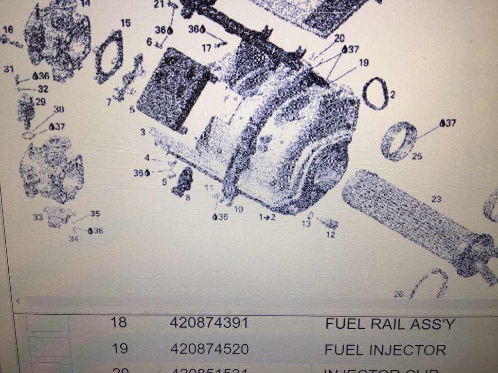

I have a 2007 Speedster IC and I'm trying to locate the part numbers for the fuel injectors. I've looked through several online sites with parts diagrams but I can't seem to find them. Can someone please point me in the right direction?
This stems from having issues trying to start my Speedster after running it for 20-30 minutes. Someone on the forum mentioned it may be a leaky fuel injector. I just received my boat back from the shop and they said they could not duplicate the issue. The only difference is that I run the stereo when I go out and the mechanic did not. I'm going to disconnect the stereo the next couple times I go out and see if that makes a difference. The mechanic also mentioned that the 2 new Optima Blue's that I put in may be an issue. He said he doesn't believe the on board charging system (magneto?) could possibly be strong enough to recharge the optima blues. I had them replace both batteries with deep cycle ones so we'll see what happens. I just want to be prepared that if it's not electrical, the next thing I'll try is to replace the 3 fuel injectors. I'll also check for "hydrolock" as someone else mentioned but not sure exactly what that is. Thanks for any help.
