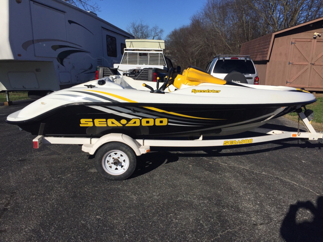

You might consider a vinyl wrap. I wrapped my 96 speedster myself. Cost me 125.00 for the vinyl background. Did it over a weekend. Used Avery supreme wrapping vinyl. I'll have to admit, it wasn't easy but it was faster than painting.
wow so the whole hull is a vinyl wrap?!! did you paint the rub rail as well? looks damn good man!
