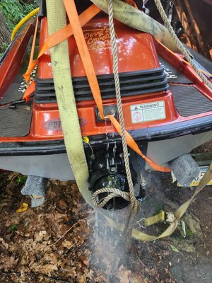

Yes, getting some water out the holes on the transom, from the two clear tubes. When running on the hose. I don’t think I had any when running in the bay. Kind of hard to tell from the pic, I have a video but I guess forum is set not to allow.

When you flush the engine it is in reverse of the flow when in the water. So it is to back flush the system. So if you are not getting any water out the back when in water then there might be a blockage early on in the system.
