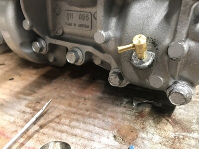

If you have a hand-held air pump. Test the check valves going into the cylinders and air compressor. I've found those to be problems in the past. They are $30 each but worth the cost of an engine. I've been able to get them clear and working properly and only had to replace a couple. I keep them on hand cuz I don't like stopping once I get started. LOL.
I had to machine this dang drain fitting at the bottom of the air compressor. Oh what was fun. LOL Be careful with it cuz you can't find them.
