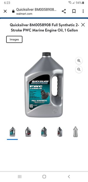

Hi folks , can I use this in my 97 challenged

I would not simply because it does not say anywhere that it is API-TC rated.

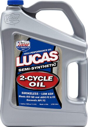

If you are looking for a less expensive oil look at the Lucas 2-stroke.
Only use the exact one below because Lucas does make some that are not API-TC approved.
I think the Quicksilver is JASO rated
I think JASO is a higher standard than API TC
Could be wrong
Also think Quicksilver used to be API TC…then stopped saying so on the label
Never had a problem with the Quicksilver
Could be wrong
JASO is a different rating system so it is hard to compare them directly.
Since it no longer states API-TC on the bottle I stopped recommending it. Also it states "Biodegradable" which would point to an TCW-3 oil and not good for API-TC engines.
