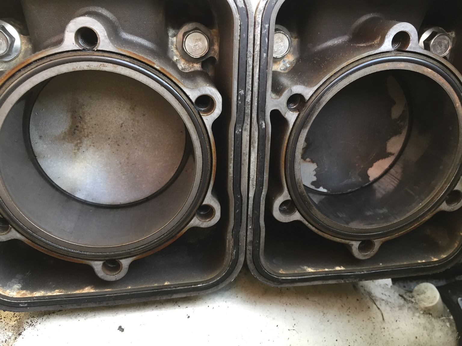

Update 08/25: thought to post a photo of the heads. It looks like a little lean on the PTO cylinder prior to the flooding. It has not been running since the hull/engine was flooded. I know that I will have to fix the crankshaft in the winter due to the seals. For the battery suggestion, under heavy load with both plugs in and cranking, the multimeter indicated 10.4-11.3 volts when the start button was held. There is a little oil that is on the cylinder walls after attempting to crank it over when I took the cover off.

That piston is super lean.
Got the ski to run today, ran it to ensure I got all moisture and remaining water out of exhaust system. Ran well for about 30-40 mins on the water. Shut off while out on the water. Seemed to appear to be a battery issue or so I thought. Now that I look into the PTO cylinder, it looks dark and not able to crank over at all. I think the PTO piston is seized now since there is a little debris inside the cylinder. I assume I have a seized piston and will need a new top end? Or do you think blown motor and need to go to SBT?

Also you need to find the reason why it ran lean and seized.
My guess is dirty fuel system or carbs.
Have the carbs been rebuilt? Does the motor spin by hand with plugs out? Get an AGM Battery for it and never look back. +1 on dirty fuel system and carbs? Did the engine take on fresh or salt water? It almost looks like dried up saltwater ontop of the piston.
