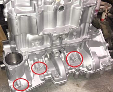

I have a 951 that has a broken oil injection nipple. How do i go about getting this out and also getting a new one?
I'm trying to picture the carb engine nipple locations. I modified a pair of Vise-Grips many years ago. I made a slide hammer out of them. I clamp the fitting with the Vise-Grips (Gently) and use the slide hammer to (gently) remove the fittings. The fittings are not tight and are easy to remove. With the slide hammer rig I can remove and replace the same fitting without damaging it. Fittings cost $30 and I keep a couple of spares. Picture is of the fittings to which I believe you are referring. This is a DI but the Carb model fittings are on the opposite side of the engine. These fittings are actually check valves.
Re-inserting I use loctite 609 and (gently) tap the fitting into position. Easy Peasy. Good Luck.
