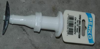

I ordered two PERKO parts from here:
http://www.jmsonline.net/THRU-HULL-CONNECTOR-1-2-**.htm
came to about 10 or 12 bucks with shipping.
I'm not sure if it comes with a rubber gasket or not, but if not I'll just buy some sheet rubber and cut one.
One of the holes already has a 1/2" hose on it, so I'll just clamp it in place. The other will need a short piece of 1/2" hose and a reducer to the 3/8" hose...
That and a 13/16 in drill/hole saw, and I'll be through with the sieve they call a "tank"

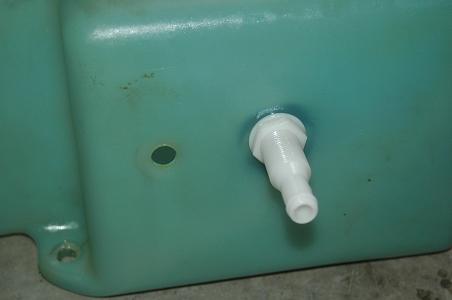

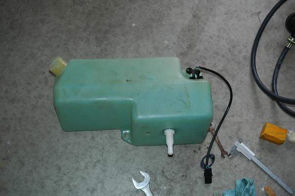

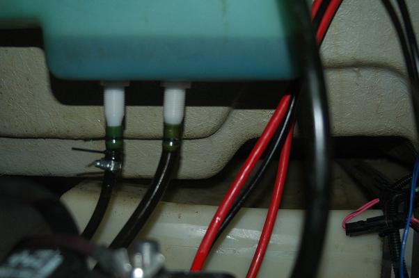

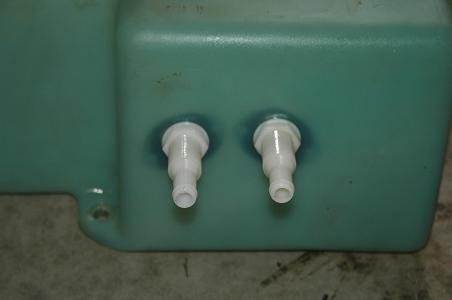

Okay, I modified the oil tank with the thru-hull fittings today, install was a pain, since I couldn't fit my hand into the tank, but it worked out in the end... And no more leaking!!! Yay!

The fitting:
The tank with one of the holes drilled and the first fitting installed:
With the second fitting drilled and installed:
Installed in the boat (a reducer was necessary for the left oil line, since it is a 1/2" hose fitting and a 3/8" hose):
