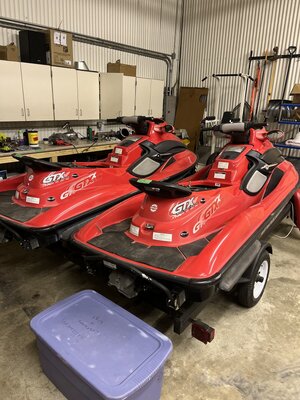

Hey guys I’ve got a pair of 2001 gtx 951 di’s. I put two new top ends on them over the winter and finally got them almost all put together. How do I no 100% that they are getting the correct amount of oil to the top end? I spun the oil pump over with a drill and it was pump oil on both of them and the injectors checked out. I was thinking just read plugs. I just have a lot of time and money in these things now and don’t want to mess anything up. I’ve also been reading some mixed opinions on what ratio to mix in the fuel tank on the initial start up. Im thinking 2oz per gallon. Thanks In advance!
