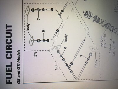

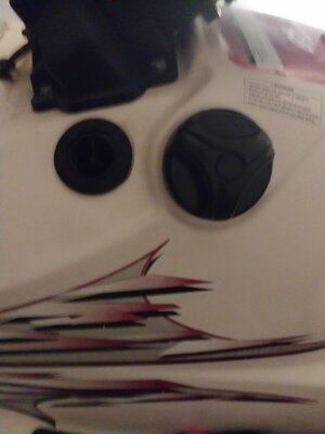

The ski been sitting for 2 years, I did add 3 gallons to fuel tanks, Should I try blowing compress air into the 2 lines leading into tank
If it has been sitting for two years you should drain the tank completely and put fresh gas in .
I added 3 gallons big mistakes, I tried a siphon hose but did not do anything. Is the reserve part of tank, closes to engine. I could see some gas in that part. I thought about blowing compressed air threw gas line.
Remove the return line at the carb, cover it with your thumb. The hose, not the carb fitting.
Blow into the vent line of the gas tank, low pressure like by mouth.
This will force gas from the tank through the carb. As soon as fuel comes out of the return fitting on the carb put the hose back on and you have primed the carb and fuel system.
