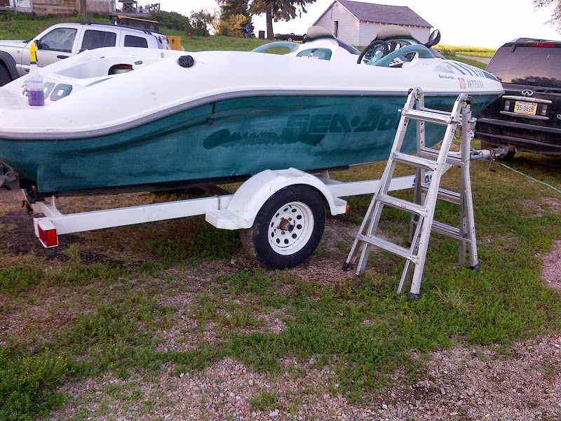

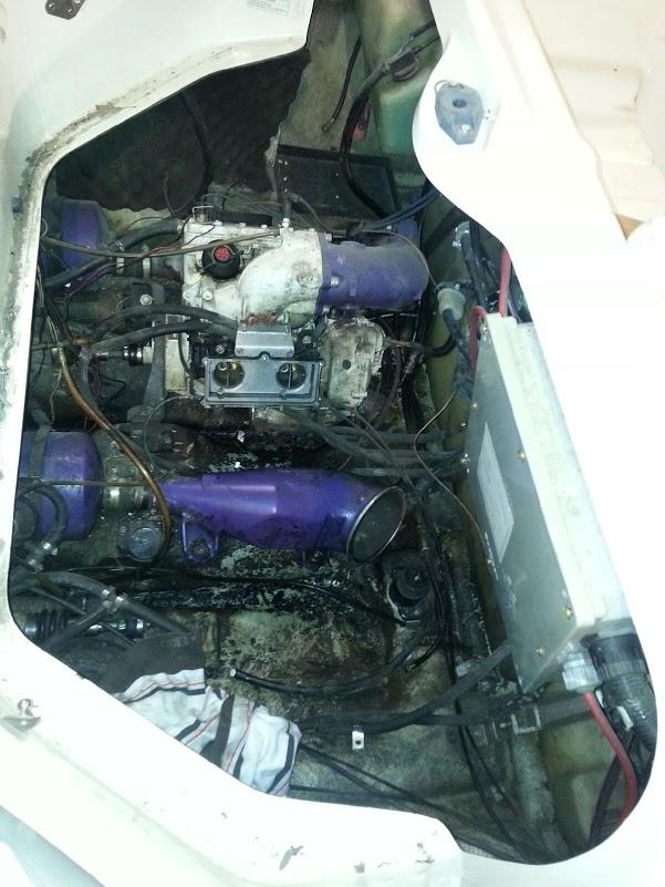

I just picked up this 1997 Seadoo Challenger 1800 two days ago its going to be a big project but I thought I could document the progress and get a few questions answered.
Details
One motor Out of Hull and Rebuilt.
Other still in Hull and Spins freely (told it ran great)
Interior Bad Very Bad Foam torn missing.
Exterior Most Decals missing pretty bad oxidation should clean up. (with a good buffing)

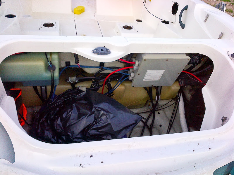

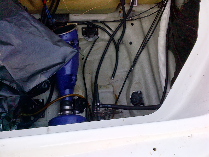

Last night we cleaned and cleaned and cleaned the engine compartment. We were careful and covered the MPEM and the carbs on the second engine. I think it came really clean i was very happy.

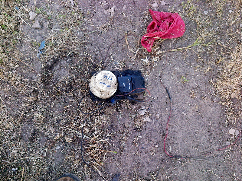

Also found this
I tested compression on the one good engine gauge read 135 in each cylinder in my experience this gauge is always about 10psi low. Pulled the spark plugs and replaced with properly gaped plugs. After the test I was able to start the motor and run it for a few seconds, Sounded good.
Next will be to order some parts, I will pull the pumps and change the oil in them also allow for the alignment of the second motor. Clean and buff the inside and out.

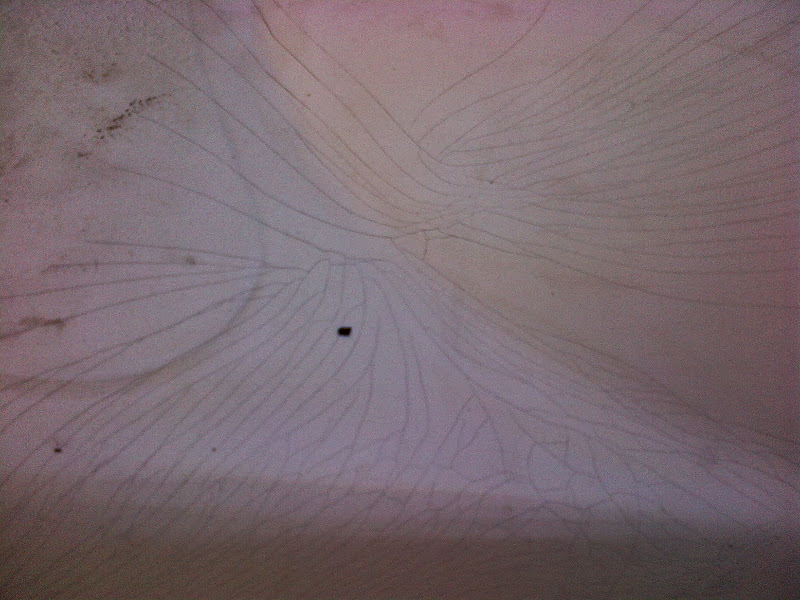

Any opinions on how to fix this

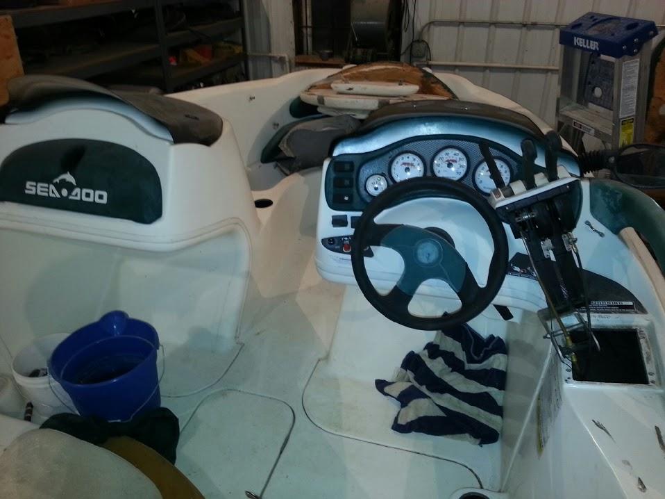

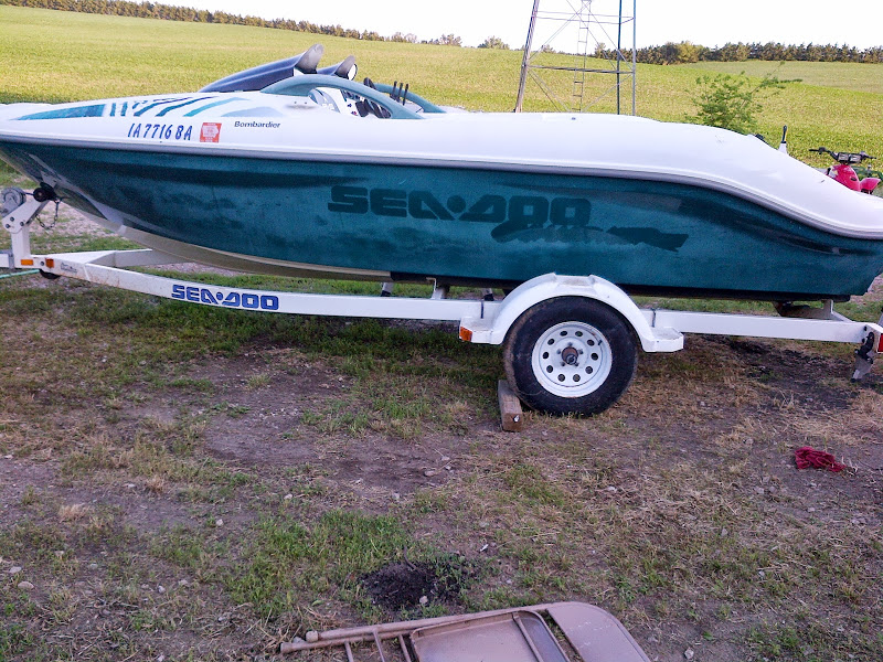

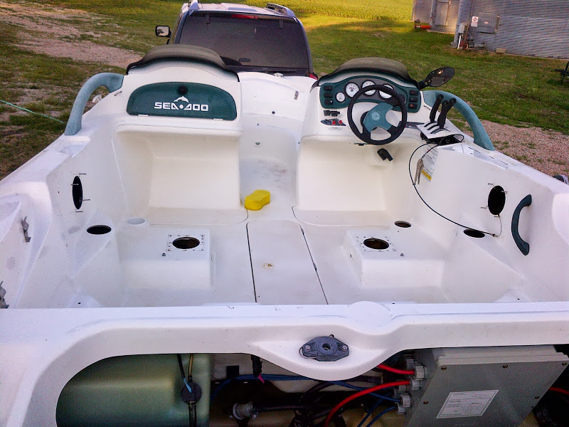

A few exterior pics

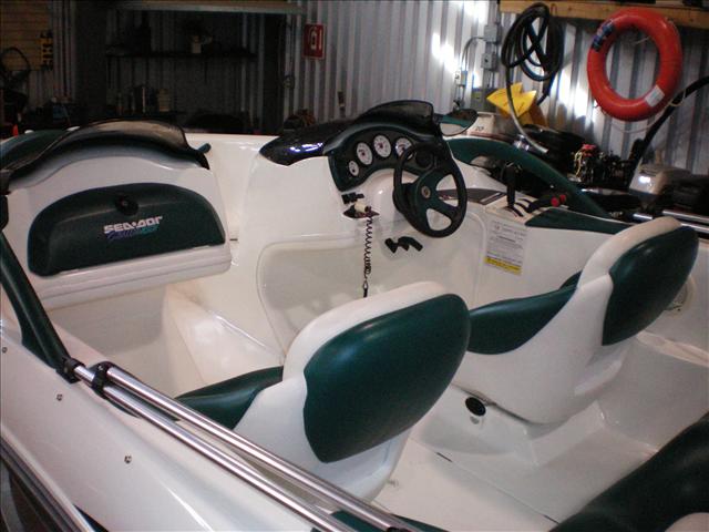

Also any help on this would be appreciated, I learned that i am missing the back pad of the captains chairs, The pad that on the back side of the chair at the top in my case it would be green, Its purely decorative but I would like to replace them does anyone have any pictures of the piece i could look at to make a frame out of an abs sheet?

wow, those helm seats are so much different than the 98 seats... I`m not really happy with the 98 seats. Those look groovy and comfy tho!

I really like the seats in the 1997 however there are a lot of pieces to them I hope i can locate that back green pad someday.

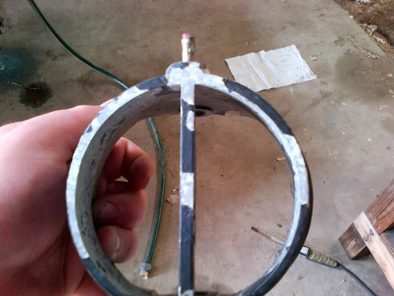

Thanks for the help on the throttle cable I was able to find one on eBay New OEM shipped for 135.00. For my next issue both steering nozzles bolts where the rode connects them together on the bottom on the nozzle are bent. One so bad the connecting rod was stuck on it. I tries heating it up and bending it but managed to break the bolt. Looks at the pic bellow. An ideas what now?
