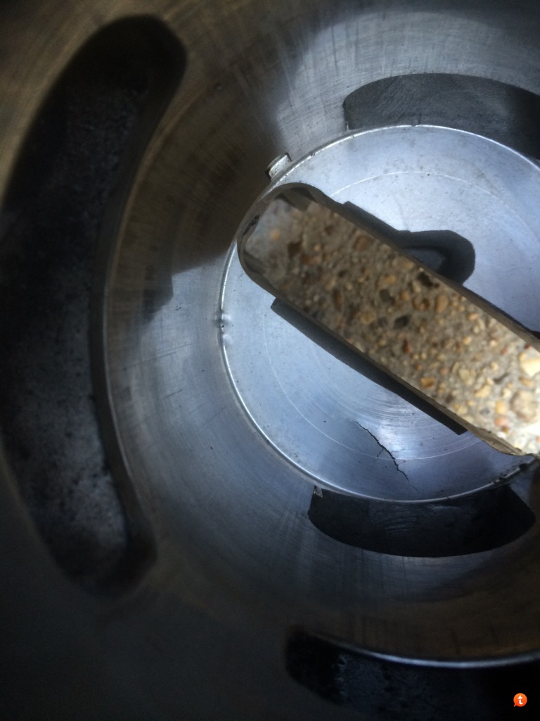

damaged cylinder.

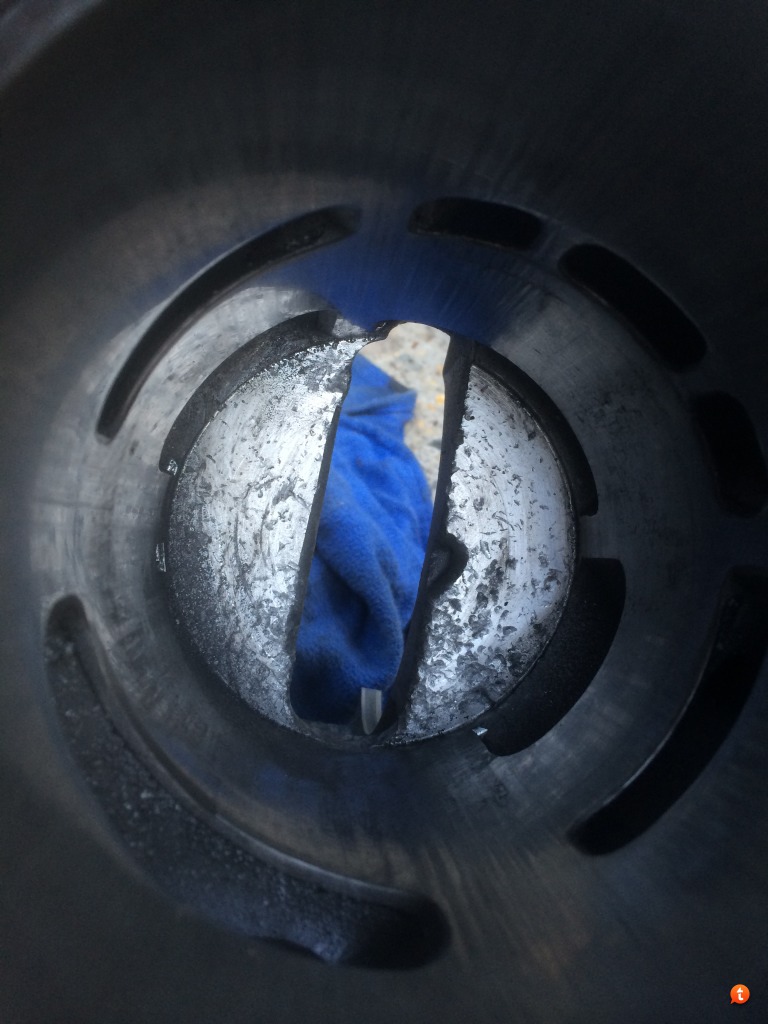

fracture on opposite cylinder...

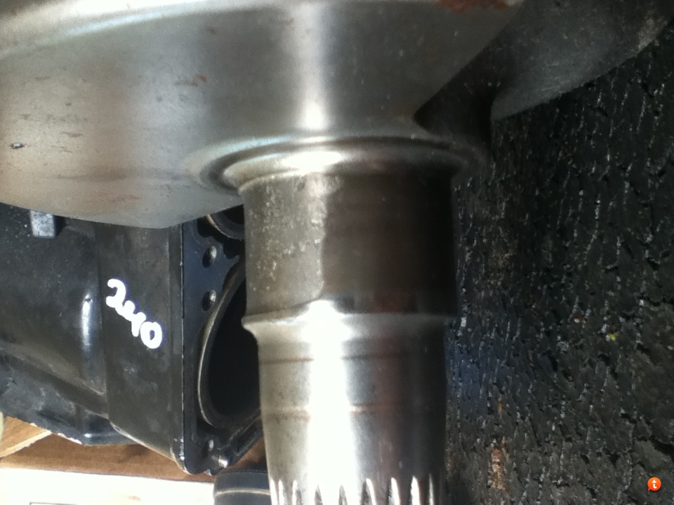

crank damage. What y'all think is it fixable? If so can I just take it to a local machine shop?

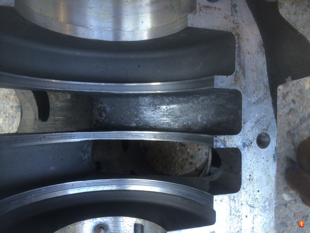

pick of where pieces of piston fell down on crank and beat up the case ( and what caused that large stress fracture in bottom of cylinder in 3rd pic

Crank: It's ugly, but there are shops that can weld up that journal, and regrind it. Marine Crankshaft is who I used. They have been around for a while. They welded up 4 of my journals, fixed the lower seal surface, polished, and rehardened it. It was $500 with shipping.
Engine Case: Believe it or not... that crack in the bottom of the cyl is superficial. Some one with a TIG welder can fuse that together in about 30 seconds. Heck... it would probably be fine as is. (as long as you can't see thought it) In a 2-stroke... the case has to be air tight, so you don't loose air/fuel mix to another cyl or out of the engine.
CYL's: I would hit the rough cyl with a hone, and check for roundness, and size. It may clean up, and you can throw in a new piston. If it's too rough, have it bored out one size over.

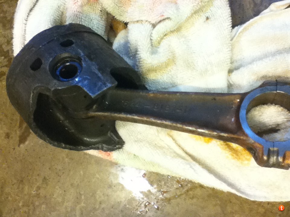

MISC: I would check over all the rods, and make sure they are OK.

What should I look for on the rods? His is a pic of the one on the bad cylinder.. It was hitting the block
