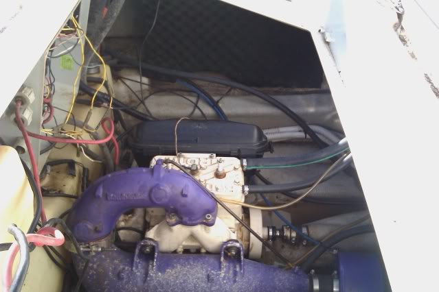

Hi, I just bought this 1995 Sportster for 500 bux. It was pretty dirty and hasn't run in a few years. The ignition key is missing, battery gone too, and looks like some wires in the engine compartment aren't plugged in. I tried plugging the battery up, noticed there are two black negative cables. Was wondering if anyone here could help me out with some suggestions or some links to follow, thanks.
Looks pretty good for a $500 boat.
Yes... there are 2 grounds that both go to the battery.
I would pull the spark plugs out, and make sure there is some oil in the cylinders before trying to turn it over.
Since it was sitting... I would drain the oil and the fuel, and replace it with fresh. Also, in the oil system, there is a little in-line filter. Change it, then bleed the system to make sure the injection pump is working. If you see any hard oil lines... replace them too. Normally the only failures in the SeaDoo oil injection system are from plugged filters, or broken oil hoses.
Get your hands on the service manual to help you clean up the electrical, and do all the regular maintenance.
Good luck :cheers:

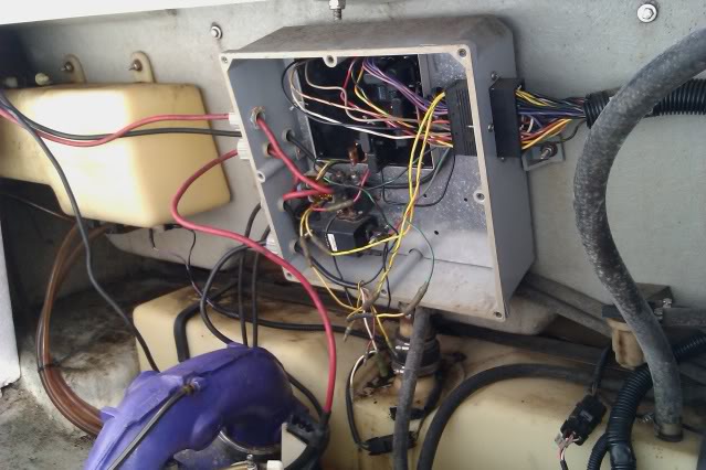

Thanks for the info. I figured I would need to drain all the fluid and do all that good stuff. I was able to get a manual for this thing too last night off a download site. The main problem though now, is I don't seem to have power to anything in the boat. Bilge pump, blower, lights, nothing. After doing some research I found that my boat has DES and of course the lanyard key is no where to be found. Do I have to have that plugged in to even run the electronics?
