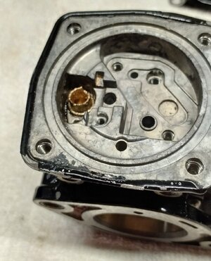

I'm trying to rebuild my carbs, so I have a new needle and seat set from OSD that is the correct set. However, I just cannot remove the old seat from the carb body. As you can see I've basically destroyed it trying to get it out, and it won't budge.

Still won't come out. At this point I can now rotate them somewhat easily, but absolutely 0 vertical motion. Any other ideas? The only other thing I can think of is to drill it out on the drill press, but that option scares me since I really don't want to damage the carb body underneath the seat if I accidentally go too far

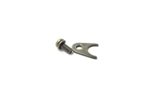

I guess it is kind of hard to tell from the picture, but the retainer is out and has been out this whole time
Maybe if there’s enough room make some cuts on the inside of seat, not quite all the way through so as not to damage the carb body but it may still relieve enough pressure to allow it to come out. I can’t think of a cutting tool small enough though. I’m thinking the o ring in there must not be seated properly and is binding
I promise I took the clip out. Look, here's another picture with me holding the clip that I took out

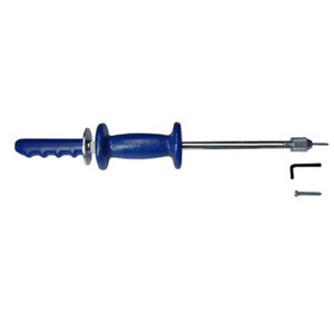

You could try a slide hammer with a screw going into the seat, just don't go too deep.
I liked the screw idea, but I don't have a slide hammer. I ended up putting a screw into them just far enough where it was gripping, clamping the carb down to the bench, protecting the carb body with a towel and then prying the screw + seat out with the claw end of a regular hammer.

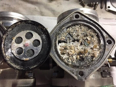

Yeah, must have been a cheap knock-off Needle Valve because those Carbs look clean and corrosion free, unlike this one...
Yeah mine were surprisingly clean even before I put them through the ultrasonic. That one from your pic on the other hand.... I don't even know if that's save-able lol, those look pretty rough. Did that ski sink in saltwater or something?
Definitely a Saltwater Casualty. Not mine. I don't treat my Skis that way.
Just some examples of some mistreated and neglected Carbs to make my point.
