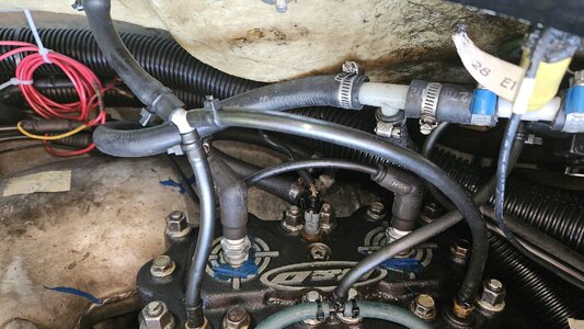

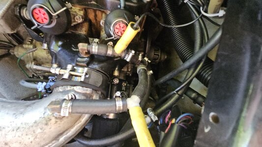

After some start problems it was running with about 5500 rpms a bit. but very rough. 2 or 3 times it was going about 6000rms +/-.
We noticed that the jet gets way to hot and started to check the cooling circuit for maybe a clogged line or something.
At this point and some research i found out that it got an aftermarket pipe (rossier), a R&D Head and some other modifications and other bad stuff maybe.
There is no flush plug at the back of the jet. There is a Connector at the top right but goes only in a loop to the pilge pump.
I noticed that the water pressure regulator on top of the waterbox is plugged. Also iam not sure if the hose connections are right because
of the different exhaust.
I found a box labeled Micro-Touch FP-ECWI-UNI that should go with the pipe i think but some wires are disconnected and also i did not
find a Water pressure solenoid that i think is needed to operate it right. Also it look like there are 2 jumper pins and 2 cutted or missing one next to them.
I did not find a single document about this part and its wiring or setup. I found something about hardjetting and inserting jets in some fittings or pipes
but that gets way to complicated ^^
Maybe someone can point us in the right direction to correctly do the cooling hoses in this configuration and if its possible to remove the Micro-Touch box.
i dont know if i should get a used Pressure regulator for the waterbox or if this makes no sense and is useless.
I checked the rossier pipe mith a small pump on these 3 connectors (2 bridged, one under pressure) and looked like it holds pressure so internaly there should be no crack or something i think. I looked for inprints on the fittings but cant found one. We removed all the hoses coming from the jet inlet and want to redo them right.
Maybe someone can help us to get this thing running without overheating. Oh btw , There is no beeper on this jetski. Looked under the dashboard but i think its removed. i think it should be connected to PIN 18 (purple-tan) & 20 (tan-black) on the MPEM Connector 2. but it seems there are different colors.
Here are some pictures of the mess ^^ thanks for the help.
