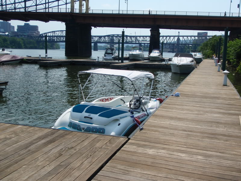

I just bought a 1996 Challenger. The boat has no graphics on the hull and I'm hoping to add some. I sent a PM to Dr Honda asking for suggestions, but I wonder, too, what you guys have done.
If you've dressed up your boat with graphics, I'd be grateful if you'd post a photo or two here.
Thanks.

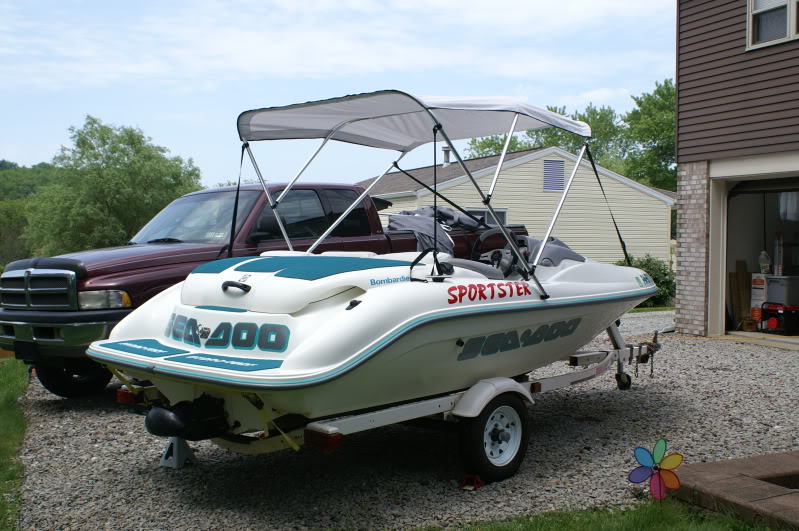

I can do a re-run of my sportster's graphics. It's not fancy... but it looked good. I did change my colors a bit to teal and silver... but we can go with the teal and purple.
Nice boat blacter,
Good find, looks sweet. Doc, how much for just the "seadoo" in the back? just asking
Thanks, DH. Couple of question. Can you do a custom boat name on the stern, rather than the SeaDoo logo? My other thought is keep SeaDoo on the stern and replace the SeaDoo on the sides with a large "Challenger" logo.
Also I'd like to replace the graphics around the switches at the helm. Can you do those? Also the SeaDoo logo on the trailer?
You think it would fit my boat (not sure, I dont think it has the same width and length as the 96)?
That bottom part should be the same. But measure the length and height... and I can tell you

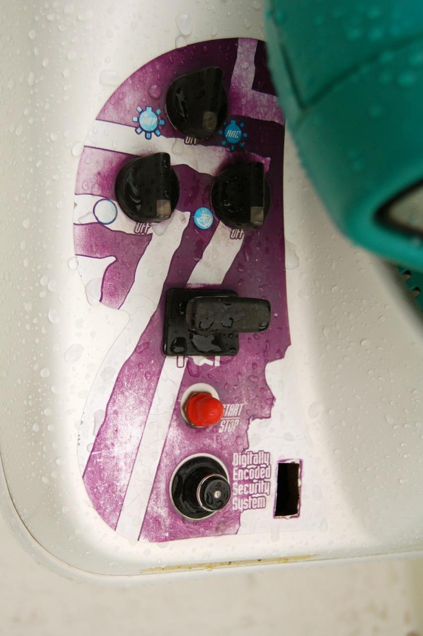

P.S. Here's a photo of the faded helm graphics. Would be great if you could come up with a replacement. BTW, any idea what might have been in that rectangular opening at the bottom right?

The hole on the bottom right isn't factory. I'd say the last owner had a switch mounted there, and took it out.
OK on the rest of it. What colors did you want?
Now... as far as the control panel sticker... I either need a "Rubbing" done, and sent to me... or I need VERY precise measurements of the overall sticker, and the hole locations.
I'll do a rubbing for you as soon as this rain stops. I'd want something much simpler in design, without the funky graphics. Also would want to cover the hole. When the time comes, what's the trick to getting the old sticker off?
I'm colorblind-ish, so colors are tough for me. What would you suggest that would look good with the purple and green?
Good... a rubbing is the best. To do it properly... you will have to remove the switches, and other parts, so I can have a clean rubbing. When you are ready, PM me for an address.
Unfortunately, on graphics that old and cooked... there isn't an easy way. If you use heat, it makes the vinyl soft... but the glue will still be hard. AND... by the time you get the glue soft... the vinyl will be melting, and you will discolor the white gel coat. All you can do is use a VERY sharp razor, and pull. I find that if you keep pressure on the vinyl, and keep pushing the razor under it... it helps separate it. (like skinning an animal) Then, you can use Zippo fluid to remove the old glue.
With the rubbing, I can cut a sticker, and check the fit. And, since I don't "Print" graphics... there won't be any funky graphics.
Let me think about the colors.
And yes... the new sticker wont have any holes in it, so it will cover the square hole. BUT... I would recommend filling the hole with some epoxy. Just put some tape on the back, and fill it. You can even put tape on the top to help make it flat. If you don't fill the hole... inevitably, someone will put their finger though it.
