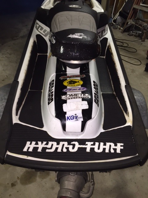

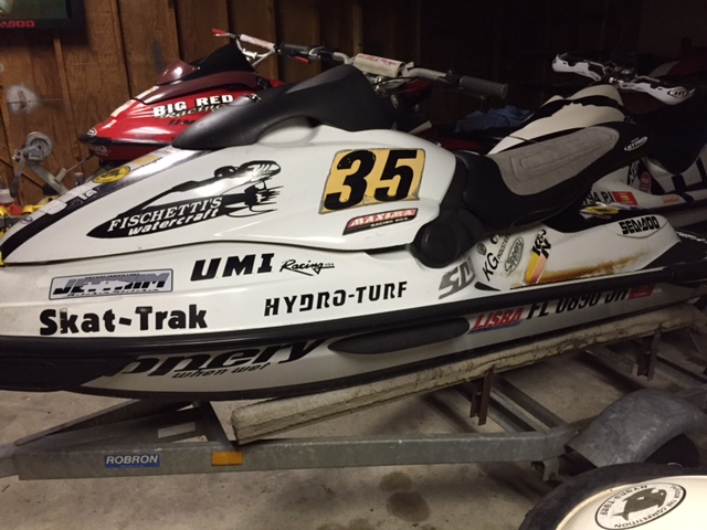

I got a lot done today. It's done actually except for the riding and tuning. I've had Hydro-Turf for this forever. It's from the mid 90's so I like that, not sure if a new set would be any different. In the original center rows of sponsor decals the HT fish sticker was trashed so I was happy to have freshies to go back in the original spots.

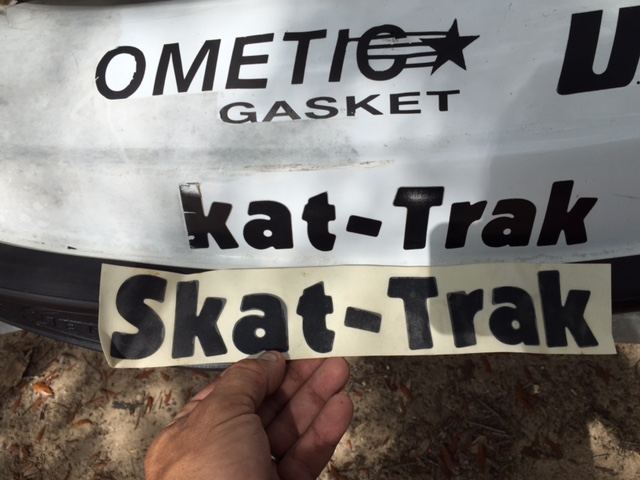

The guy I bought my old Fischetti built X4 from was sponsored by Skat Trak and I got all his decals. It pays to be a hoarder because I had the exact ones.
Unfortunately I got crossed with the Cometic decals that were made for it. The dimensions are the same but as you can see the originals were smaller and said gasket underneath. These would be too prominent and I don't want it referred to as "that Cometic ski" haha.
Brushing on Weldwood for the turf. I left the ole turf and padding on the outside of the inside. I picked up these Seadoo stickers of Ebay a while back and decided to spend them on the rear hatch.
Had the sign shop print me off some reg #'s today and this is where I hid them

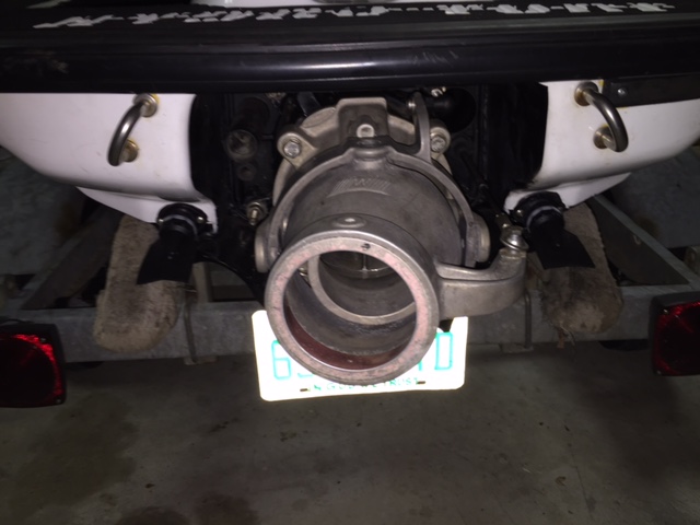

R&D reduction nozzle with Westcoast steering nozzle

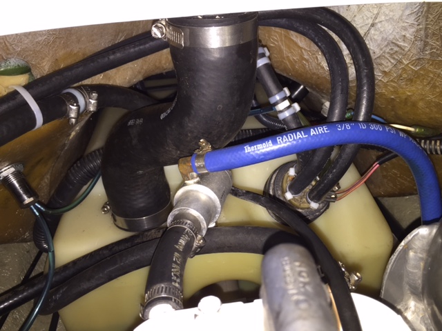

It's busy back here under the hatch. I have a 96 waterbox with most of the water flow fittings replaced with brass plugs

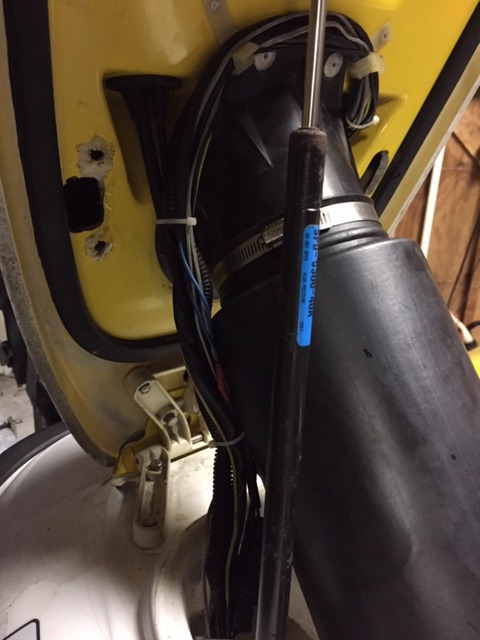

I realize that I'll have to throw that heavy hood up a lot while tuning. I took two shocks from a Speedster and installed stainless steel strut mounts to hold them. This beats the heck out of the original kick stand design. Notice the wires going up. The HX's of 95 and 96 had no gauges but luckily they made me a place for some.
A friend made me a carbon fiber cap a while back and I decided to use it here
Here is a better strut pic. Lou mention the Duracell AGM batteries that came out with a two year warranty so I got on that.

These remote fuel pumps should be mounted remotely. Racers say the vibration from the engine can create air bubbles so I got under one of the front sponson nuts

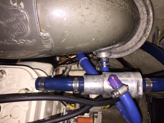

Here is a pic toward the back. I'm using Factory pipe billet filters because I don't want to clog up the jetted fittings and they are great to tie water lines into.
The other billet filter runs the water injection and the added chamber fitting
Now it hangs in the hanger waiting for a test and tune
