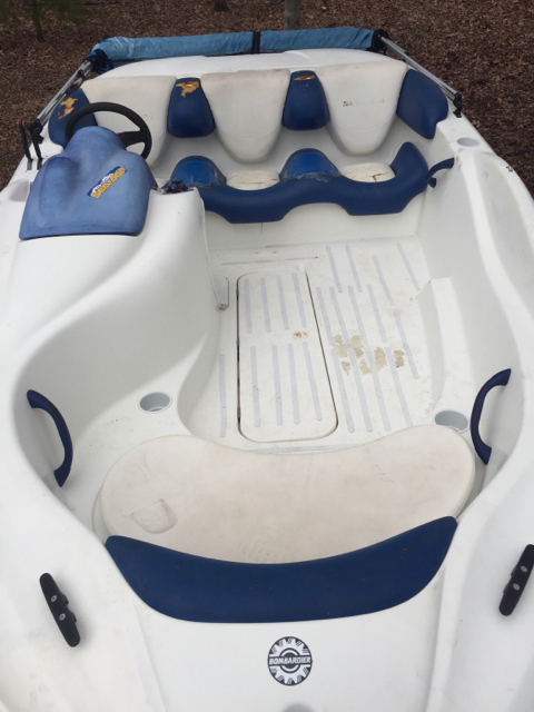

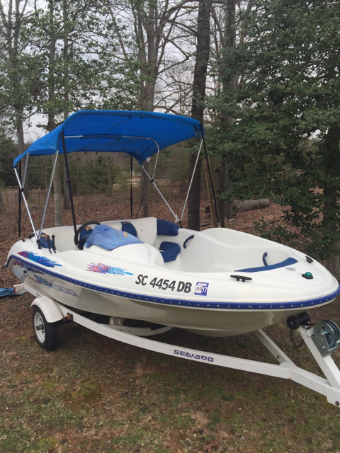

Have never owned or ridden in a Seadoo boat, friend of mine had a 1997 sportster with a single 717 that he was looking to get rid off. For the price I couldn't pass it up.
Good, even compression, decent shape overall except seats. Bimini is in great shape
Plans are to clean it up, typical engine once over, buff, recover seats.
Looking forward to taking it out for the first time
Any thoughts, tips or anything I need to watch out for on these boats?

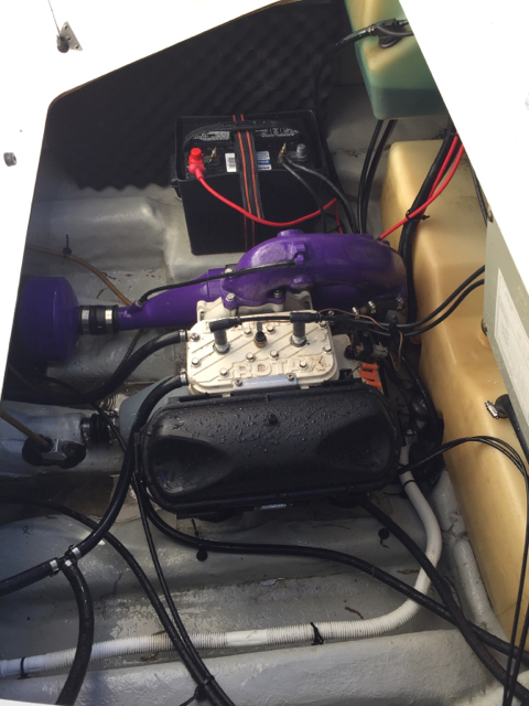

Engine pics
I have a pontoon currently, and a few seadoos, if this one turns out good, maybe I'll replace my ski with a twin engine in the future.

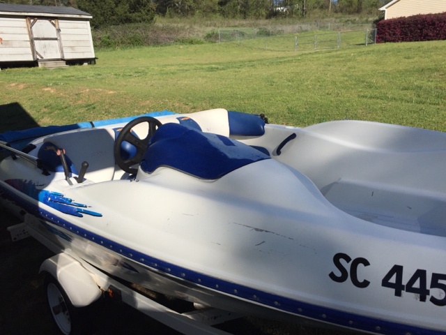

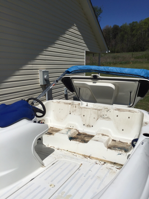

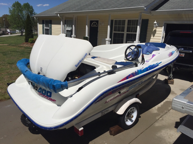

Got around to cleaning it up, started on the hood with the heat gun, pulled some of the torn stickers off, cleaned bilge.
Rear seats are coming off next

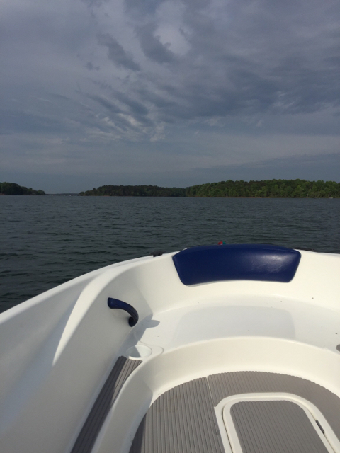

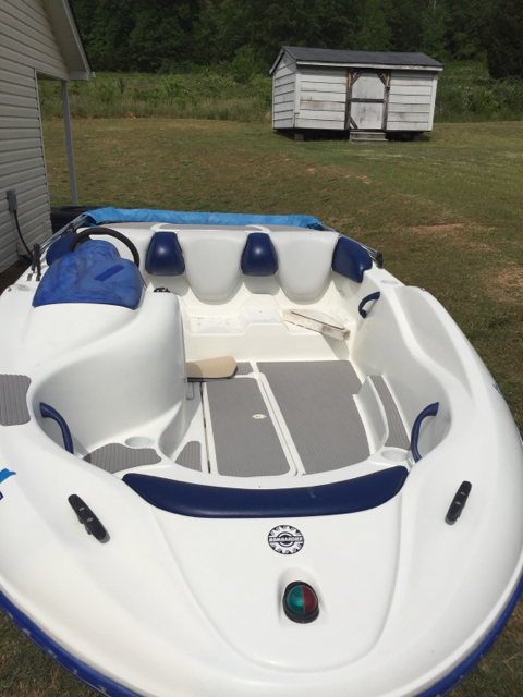

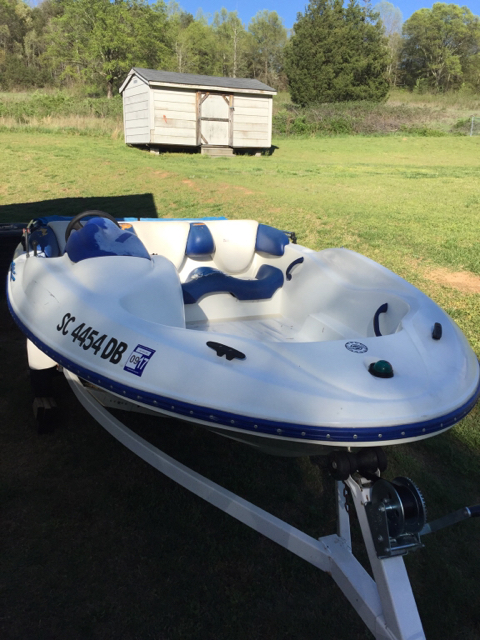

Finishing it up slowly, actually splashed it for the first time yesterday.
It ran very good, starts right up, no issues.
Ran 39mph with me alone and 36 with my cousin and I
Very happy with it, very fun, I will be keeping an eye out for a twin engine [emoji13][emoji41]
I changed the old tcw oil they were using, all the lines, cleaned bilge.
Cleaned carbs
Finished up the upholstery
Removed a few decals
Installed hyrdoturf
Rub rail insert that was missing
Still need to install the lower and front seat

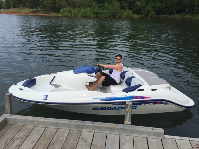

Little cousin, first time driving a boat
