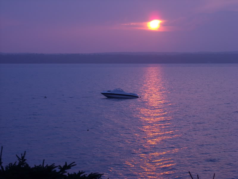

Well it would be moored out in front of my cottage at an actual mooring, like so
and I don't have to worrie about anyone steeling it, this section of water is not heavily populated and everyone else who moors their boat out their I know. I guess my main concern would be not having a bilge, and the salt water sitting in the motor.

I'm with SPORTSTERJOEL. Your boat isn't necessarily water tight. Many a boat and PWC owner has come out the next morning only to find their vessel's engines under water. You gotta be careful with that overnight stuff!!

For whatever reason, boats leak. Some faster than others. Just a suggestion.
Take it and moor it for a few hrs, and check it for leaks. The shaft seal is probably the source of some leaks. Once you determine that it's leak rate is within your time budget, then you are probably ok. That is, it leaks a quart of water in xx hrs. Then go and check it again.
If you left it for 3 days straight, and then found a foot of water in the engine compartment, that would not be funny! But if you check it every day, you may be ok.
Maybe a cheap bilge pump, hooked to the batt, that has a float switch would be cheap insurance.
After this little vacation, rinse her out good.
