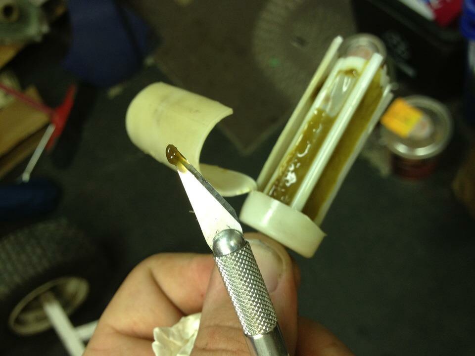

This is why you change everything at once. You can see that the filter was so plugged that the oil pump sucked the filter mesh in. The oil lines were getting random bubbles of air in them from the starved feed line.

AND THIS IS WHY !!!!!!!!!!!!!!!!!!!!!!!!!!
2-stroke oils are not like automotive oils. The additives DO NOT always mix. And, in something like the filter... it can gel, and then you have no flow.
If you don't want to do it right... then buy some Lucas. I don't know if it's worth a crap in our engines... but it safer than mixing.
