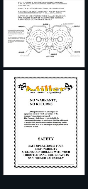

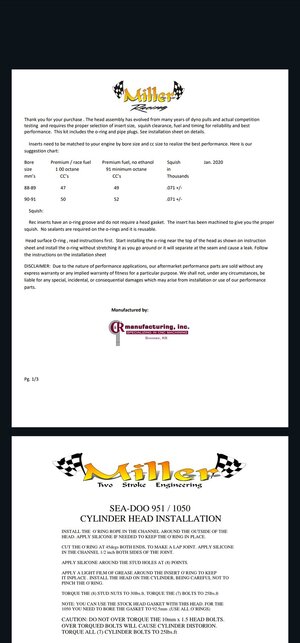

Squish is the most important thing with miller heads
