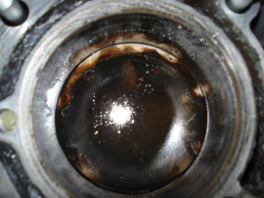

pics of the rave valves and the milky port
it sure looks like water is getting in that cylinder, I'd unbolt the cylinder head cover and take a look

3) You are getting water into that engine... but only a little. It could just be condensation from water in the exhaust.

im pulling the head off now and going to check into that
upon removal of the head i did not notice anything out of the ordinary ill post pics, where is it possible for water to get into this engine and how do i go about testing this?
did it look like the head had been removed previously (e.g. paint scraped off the heads of the bolts)? I'm wondering if previous owner maybe removed head for some reason but did not replace the gasket. post some pics, maybe Doc will see something but the important is you didn't find a cracked head. maybe just condensation as Doc said previously
