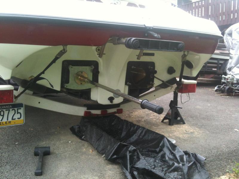

Thanks again Tony... you made some interesting points about the Islandia hull design has gone through some changes over the years. Do you know if the Challenger 1800 has gone through any hull changes and when? I'm guessing there is probably a difference between the 2 engine and single engine hulls?
I don't think there was a reall change in the 1800 hull. Obviously, they would have the rear section changed just to mount the pumps... but the forward section stayed the same.
With that said... as you know... as small change to the rear can have a large change in how it handles.
Next time you have to boat on the trailer... post a picture of the transom. I may have a few I can post of the twin engine. (I had to send pics on a boat I worked on last summer)
I will be testing my new Hoist system that I mounted in the boathouse this weekend... I will take some pics and post them up.
Here is a photo of the back of the hull... Lifted out of the water.

pretty close. But there is a small extended section in between the pumps. AND... you get more "Skeg" action with 2 pumps.
