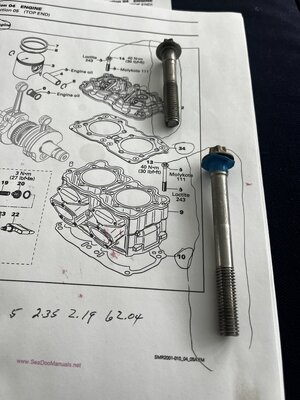

Working on a 2001 947 DI motor. My question is regarding use of Loctite 243 and molykote on head bolts. Manual states “apply Loctite 243 (blue) below the screw heads. The diagram indicates apply molykote below screw head. Which one is correct? The larger bolt I show in the picture below is the original bolt I took off the original head and it clearly has Loctite 243 blue on its bolt head.
