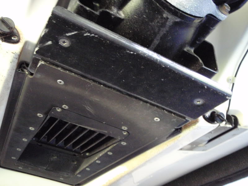

I know this is not good, but I suppose I am looking to understand how bad it is.
I have been hearing a "ticking" or tapping, particularly at idle/low rpm. Thought maybe an exhaust leak or FOD in the impeller - the noise went with rpm.
Pulled the boat & without the lanyard, turned the engine, the noise is clearly from the drive/gearbox. Was going to change the gear oil, and found this housing cracked. I did change out the oil, and with a magnet, I pulled out the metal pieces in the other pic. the oil was dark, but no sign of water, and it seemed to drain a sufficient amount.
After the oil change, the boat seems to run fine except for the tapping noise which continues. The noise either goes away or is drowned out at higher rpm.
Looking at ebay, there are at least 2 for sale in the $250-$350 range, one of them shows the same crack in a pic. Looking through the forum, a few pics have this crack too.

The second picture is not good. Are we sure it's gear, and not just a bearing failing? I guess it doesn't mater at this point, since the pump needs to come apart. So, I will just go down your list...
1) Are you sure it's a crack? Is it leaking oil? There is a casting line in the pump housing, and that's why you see it in other pumps. If it's a crack... it will be oily.
But... the gears aren't aligned using the case at that point. The input shaft comes down from the top... and the pump shaft goes front to back. Gear mesh is set with shims. SO... if you are loosing a bearing (possibly the clicking sound) the gears will go out of align.

Here's a pic I found of my pump. It's not the best pic... but you can see that casting line.
Thanks Doc. Once I take it out of the water, I will take a closer look to see if it is a casting seam. There is definitely an offset that is real, just like the pic shows (the lower part in the pic is definitely "raised" downward).

I don't think that's a crack, either.

I was under my boat on the weekend, and thought the same as you last year, but it is definitely not a crack, but the casting seam. I took a pic of mine, please see attached.
Thanks Shep! I am starting to be convinced & sure hope you're right. I will update once I have definitive evidence. Still in the water just yet.

The "crack" is clearly just the casting seam, so not the issue.
