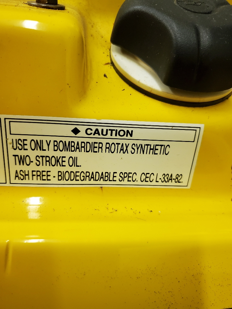

LOOK UNDER YOUR SEATS!
Use only Bombardier Rotax Synthetic Two Stroke Oil.
Now for the kicker..... Ash less and BIODEGRADABLE
But wait, tcw3 is bio, not apc-ti, wait, what? The other guys might not make their apc-ti oil biodegradable but Bombardier does. Castrol used to make the oil for Bombardier for years, now it's redline.... Right where you want to keep the tach needle...hahahaha sorry had to

I've been riding skidoo snowmobiles since the 80's and have been riding seadoo's since the real early 90's and I've ALWAYS used the recommended Bombardier oil in them. Before you tell me it's too expensive stop..... Oil injected skis use 1 gallon of oil with 40 gallons of gas(@ WOT). I would burn that much in a weekend almost every weekend in the 90's, we had 2 96 XP's. My speedster is set up for pre mix. Every tank I burn is a gallon of oil plus the 40 gallons of gas. That's $142 every weekend I want to have fun. Stop nickle and diming over oil. I know, I know, the dealer is 100 miles away, they're never open when I need them, I always forget to stop...... Mine is 2.5 miles and I still order online and have it shipped in for free. No one is buying Lucas or mystic, or Quicksilver cause they read the specs and it's light years better than seadoo oil, they're buying it cause it costs less plain and simple. You can argue that that's not true but at the end of the day it's the dollars and cents your saving is why you're not buying it.
