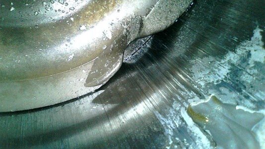

Pull the plug and use an articulating scope to inspect the cylinder. I had a bad issue last season ... melted a piston. I burned through the cylinder liner too.Cyl 3 pic 8 w_cyl wall.jpg
