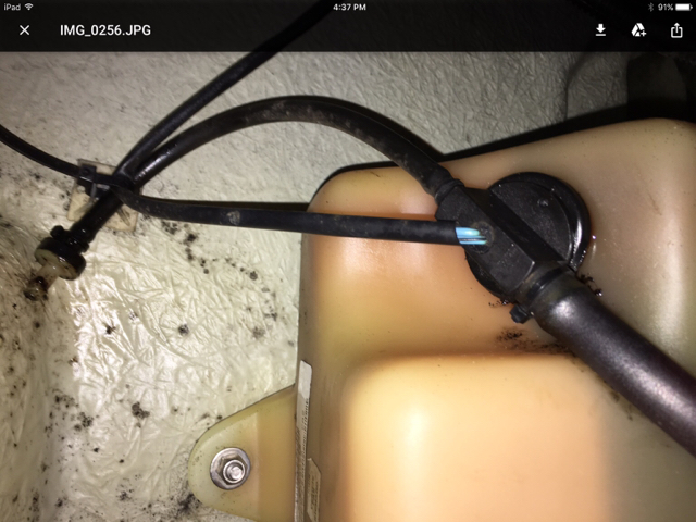

Hi there , we have a 2001 Seadoo challenger , twin rotax , oil injected.
Off the top of the oil reservoir there is a line that looks like it has a filter on it that should go somewhere but I'll be damned if i can find where it goes.
Can anyone help with this?
Thanks
Todd
I believe it is just a vent in your case.
Let a 2-stroke person confirm this, but pretty sure I'm correct.
It's a check valve for the vent to let air back in as oil goes out. It leads to noting and is correct :cheers:
