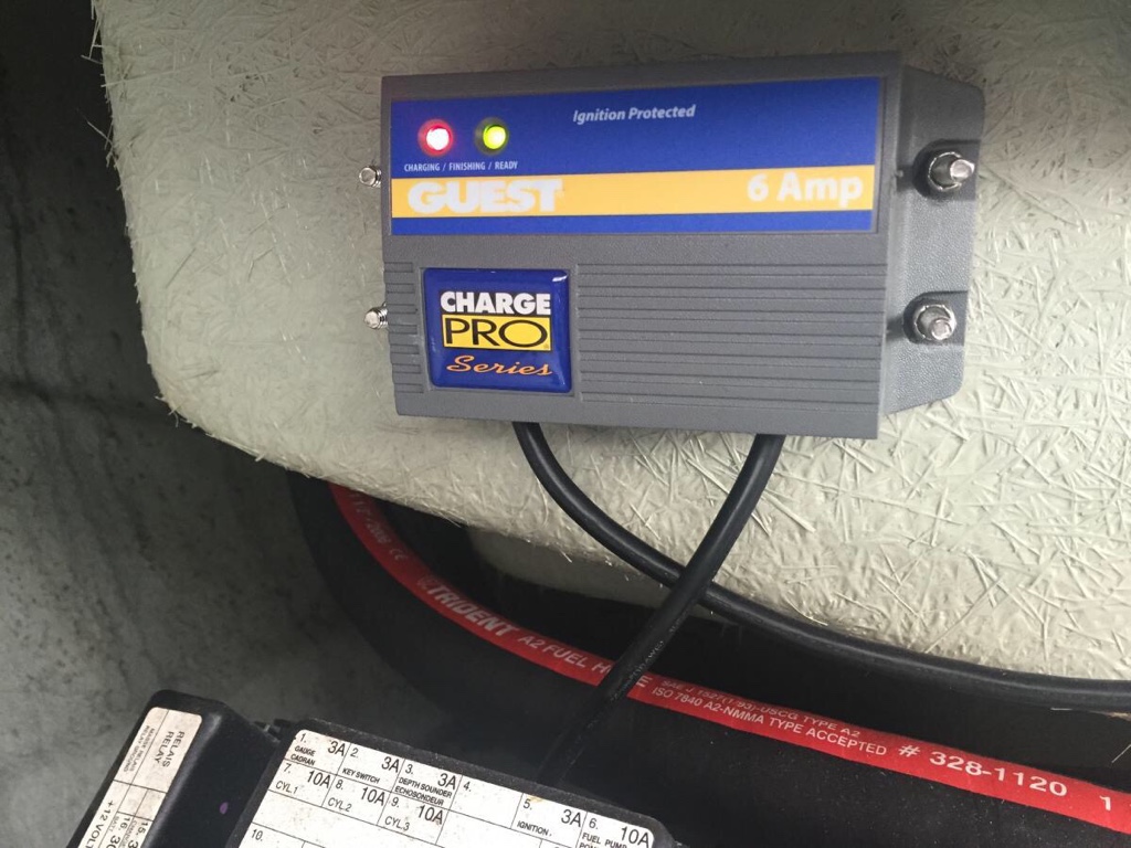

I installed a permanent on-board charger on mine. Love it. Never worry about a dead battery.
Yes. The port is a male three prong plug. I installed it mainly for coastal trips where she is in the water for a week or two. I didn't want the boat to sink from a big storm and dead battery. I do, though, plug it in all the time whether on the trailer or at the dock.
