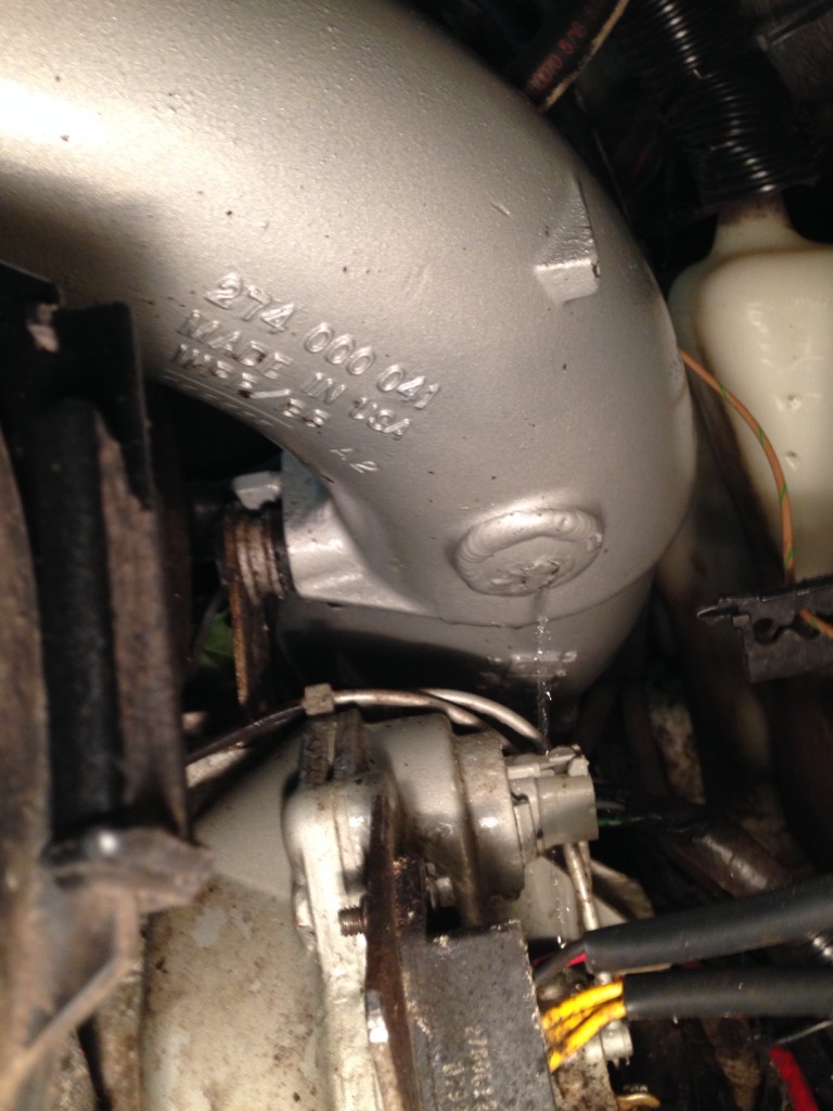

I am now part of the leaking pipe club. Running the engines on the hose and I notice some water coming out of the drain plug. I think I am going to pull them and tig plates over the plugs.

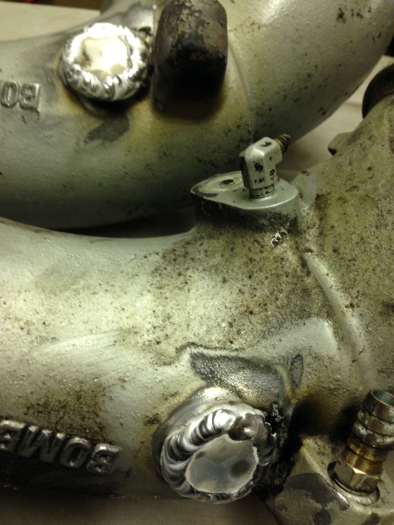

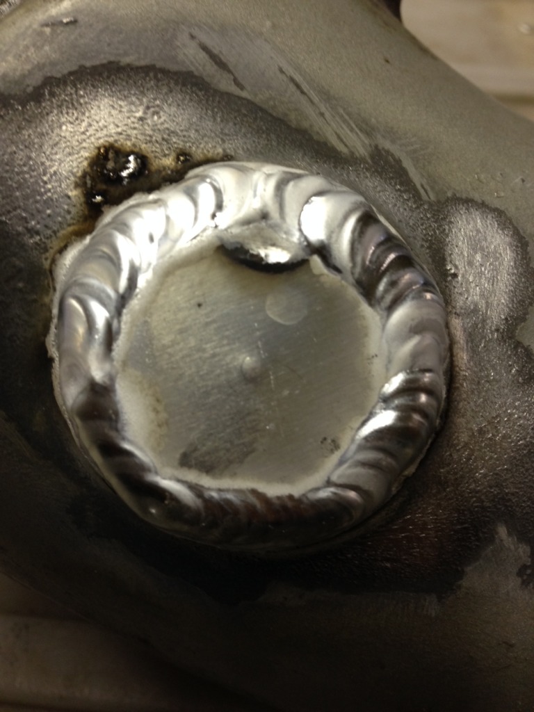

Pipes out and at my welding shop. One came out nice and easy, one not so much. I broke the nipple off the pipe for the hose running to the head. Is this a standard brass nipple or something special? For the manifold to pipe gasket I plan to get new ones, but not sure about the copper ring on the big end. Can the ring be reused or do I get that as well? Who is the best place to order from?
Pipes back for $75.
I now need some gaskets (will have another topic on that) and a new pipe nipple and they can go back in.
