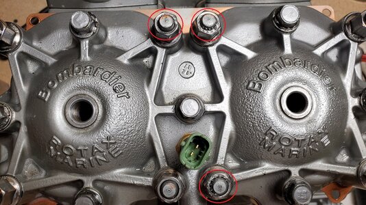

I am doing a leak down test on a 951 and it leaks at the cylinder head studs. Any idea what could cause this?

Did you use the correct stud o-rings and a good quality head gasket?
I did. I also used Copper Spray Gasket. I tried a cheap Chinese gasket for gits and shiggles and it didn't seal at all. I find it odd it seals everywhere but at the studs.

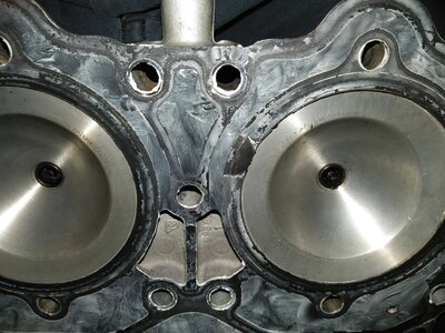

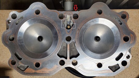

Is it possible the erosion where the temp sensor is located could be causing the leak? I have three head and they are pretty similar in erosion in certain areas. Head leaks.jpg
A machine shop decked the cylinder a while back. I put a straight edge to both and find no issues. I checked the torque wrenches and they are accurate. It makes no sense.
The only thing I can think of is the stud o-rings
If the head gasket is sealing properly, the o-rings should not come into play. I thought they were for vibration. I had one engine where they used Three Bond 1211 on the head gasket. I dont know if that was a good idea.
Did you follow the proper cross-torquing Procedure and two-stage Torque sequence as specified in the Service Manual?
To what Torque did you set the Nuts on each Torque Stage?
Were the Studs completely screwed all the way into the Crankcase and snug before installing the Cylinder Head?
Thank you for your assistance!
"Did you follow the proper cross-torquing Procedure and two-stage Torque sequence as specified in the Service Manual?" I did.
"To what Torque did you set the Nuts on each Torque Stage?" 11lbs/25lbs. I checked the torque wrenches and they are accurate.
"Were the Studs completely screwed all the way into the Crankcase and snug before installing the Cylinder Head?" They were.
Stud rings are for vibration and to seal moisture from getting down the studs.never use sealant on head gaskets.the coating on the head gasket itself is used to help seal it also.clean surface ane reaply then try it

Update:
I have two cylinders and two heads.
I tested:
Head 1 on cylinder 1
Head 1 on cylinder 2
Head 2 on cylinder1
Head 2 on cylinder 2.
I used WSM head gaskets (Copper Spray Gasket used in some cases) and both torque wrenches are reading correctly. On the last test I torqued to 30lbs. In ALL circumstances, the head leaks like this. My straight edge shows the cylinder, and the head are straight, the torque wrenches are correct, and the gaskets are good. This defies the laws of physics. Any thoughts?
I just torqued the head again and increased torque to 30lbs. The head leaks slightly by one bolt, there are bubbles on five nuts. It is better, but not right.
