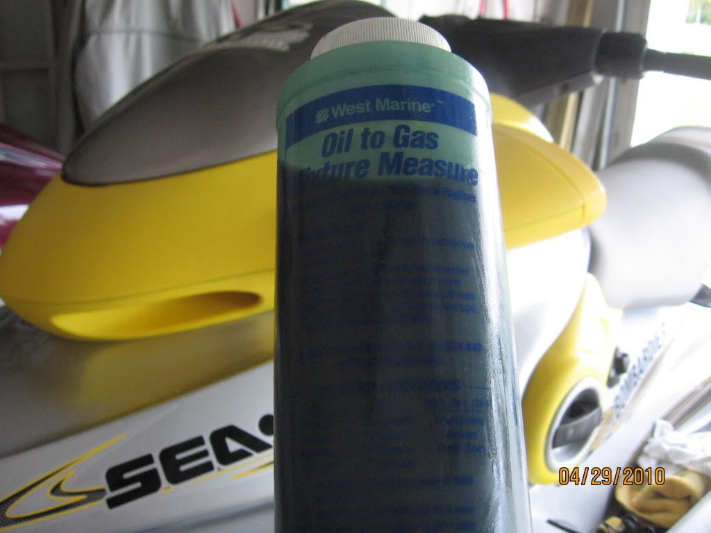

for your premixed ski, if you have a west marine nearby,, this will be the best $5 you ever spent.

premix oil container will be next to all the 2 stroke oils, semi clear container about 10inches tall, with a white lid, seals tight, gives you all the ratio's, works great, usually on the top shelf kind of hidden.
