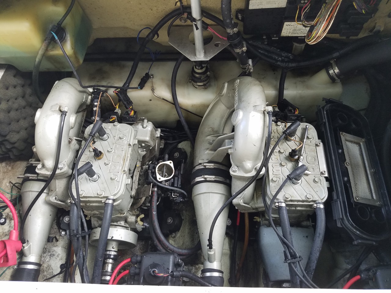

pictures? sure!
These are the original engines. I would be surprised if the boat has more than 50-100 hours on it in total.

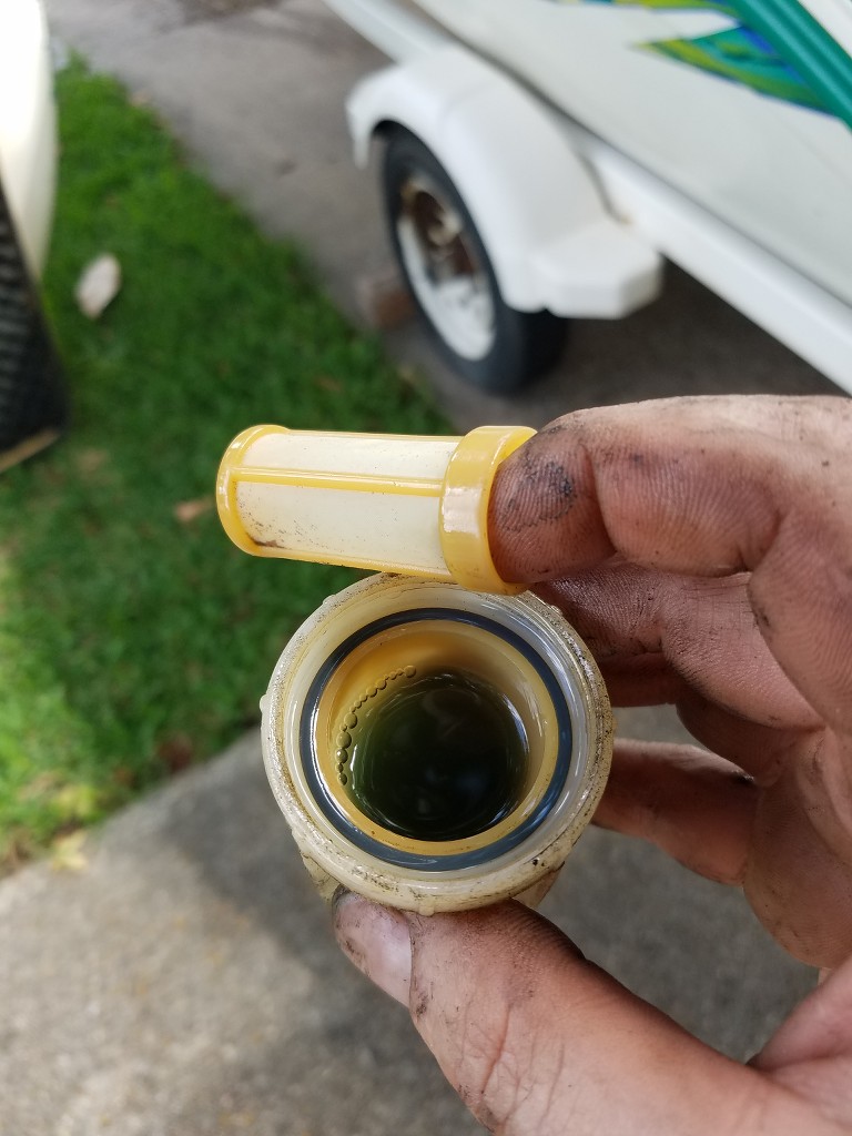

yesterday, I siphoned the fuel out of the tank. it and smelled really good. it has a slight blue tint so I am sure someone put stabilizer in it when it was put up.
I really didn't think it was necessary, but the reason why I siphoned it out is because a boat repair guy suggested I do so. I figure its always best to err or the conservative side.

2. Rebuild the carbs with only Genuine Mikuni kits and new needle and seats, See my carb rebuild thread in my signature.
3. Replace the fuel selector if it has one and the square o-ring on your fuel filter in your picture above with new ones.

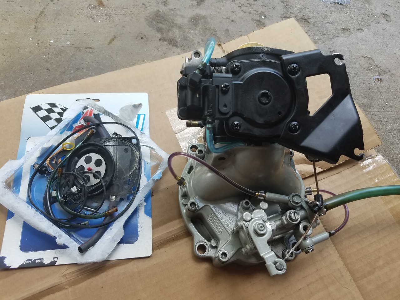

rebuilt the carbs yesterday. I used your thread miki. thank you again. there is a procedure in the manual to bench test the oil pumps. basically, you use a power drill to spin the pump counter clock wise to fill the new lines up with oil. this is obviously a pic of the port setup but I did the same with both.

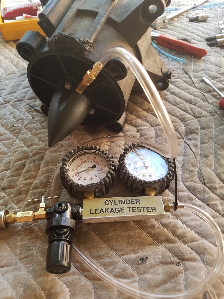

today I changed the oil in the jet drives. this is a pic of me doing a pressure test on one of the units.
tomorrow, I plan on to reupholster the rear seat and install the carbs. my goal is to get it running by the end of the day.
You really don’t need to test the oil pump.
When you get it back together hold the pump wide open and you should see the oil pumping through the clear hoses towards the manifold.
thank you miki. thats what the manual said too. I wanted the peace of mind to know I wasn't going to destroy an engine by starving it. also, I wanted to fill the new small feed hoses up with oil so the engine wouldn't run for a time without lube. I have to admit, it was really satisfying to watch fresh oil pulsing through those hoses at regular intervals for the first time.

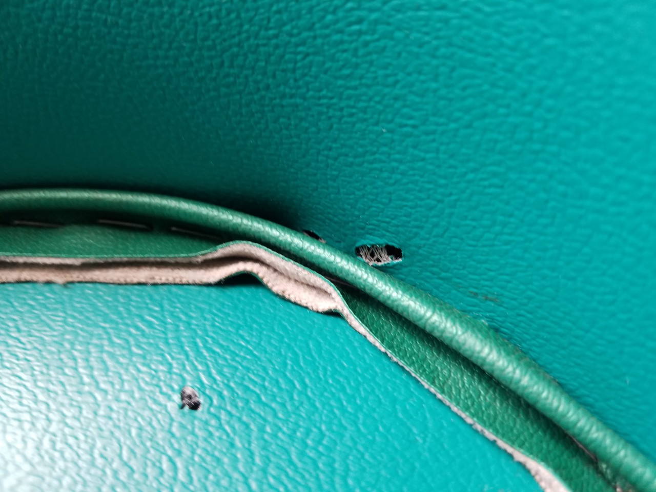

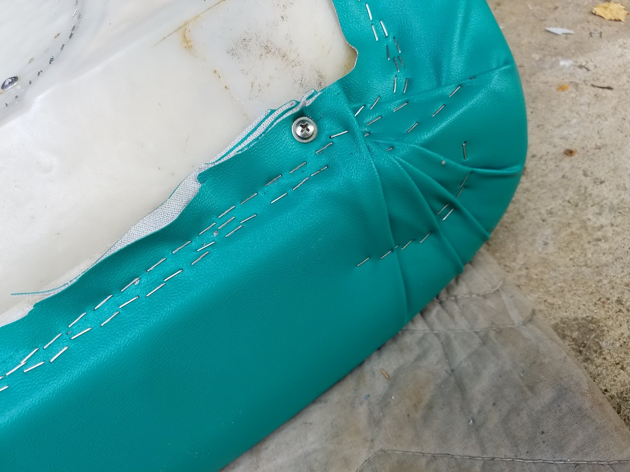

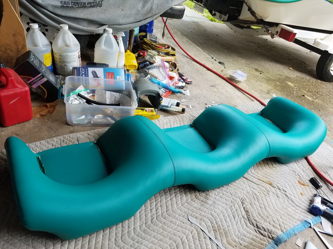

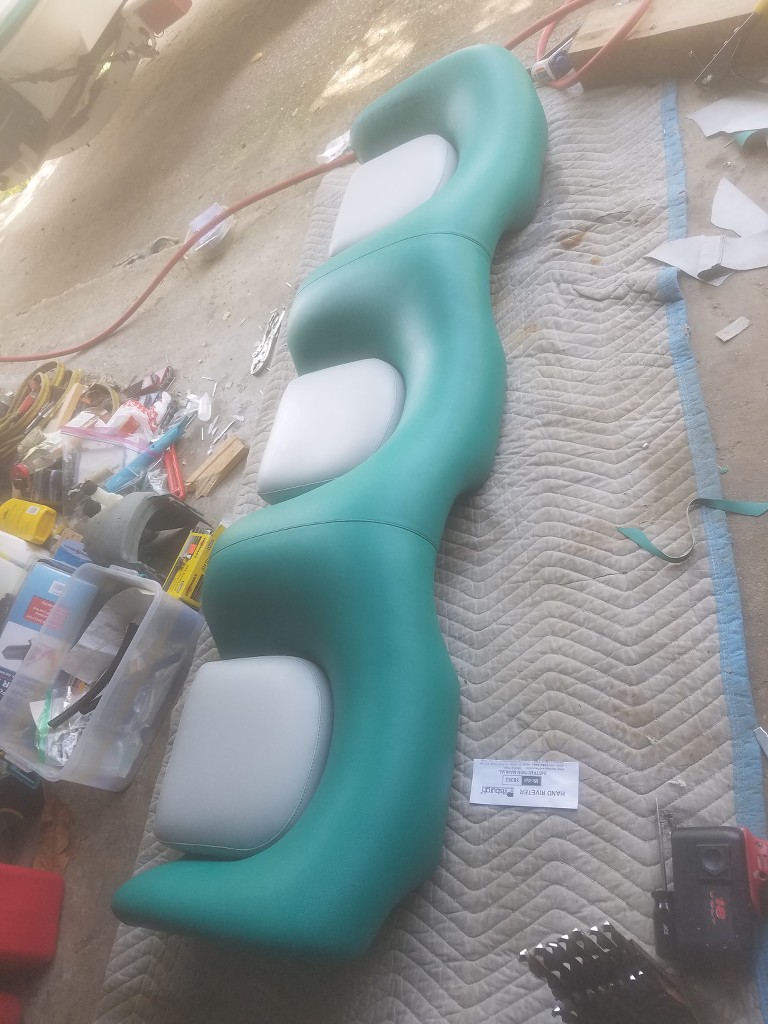

I thought I would post photos of re skinning the bottom seat. I've never done upholstery before and I have to say this was very challenging.
the biggest problem was getting staples to hold the inner horseshoe area. they either pull back out of the hard plastic shell or they have a tendency to pull through vinyl. my solution was to cut 1.5" wide strips of the covering from the old seat, fold it in half, and then staple through that.
here is a pic of one of the places where the staple pulled through before I started using the vinyl strips. needless to say the cussing that ensued would make a sailor blush. I found that every time I shot in a staple, I had to hold it in while turning the seat over to bend over the protruding staple to keep it from pulling back out. in some of the photos below, you can see all the staples in the horseshoe are bent over.
this is the finished product. well...almost.

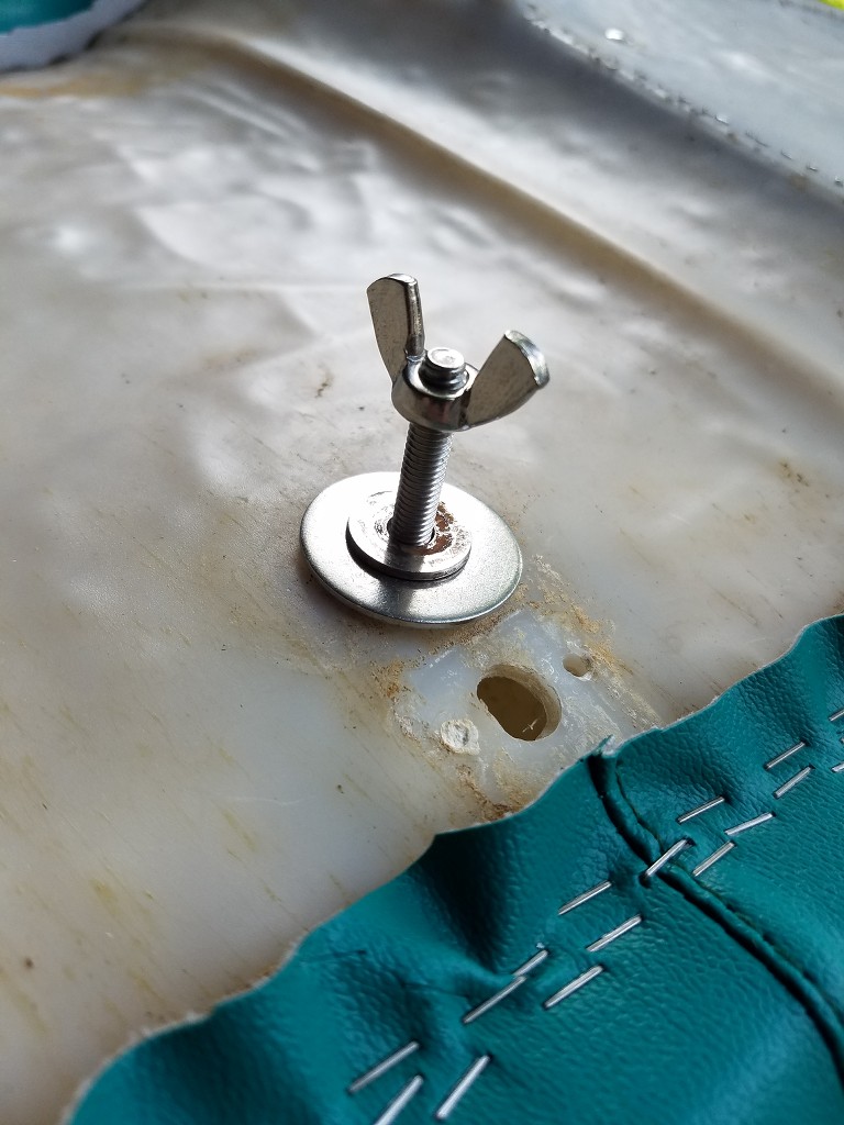

there were a coupIe of modifications. i added a #8 screw with washer in each corner on the back side where the fabric is bunched up. I didn't want to count on the stapes to hold it together in those areas.

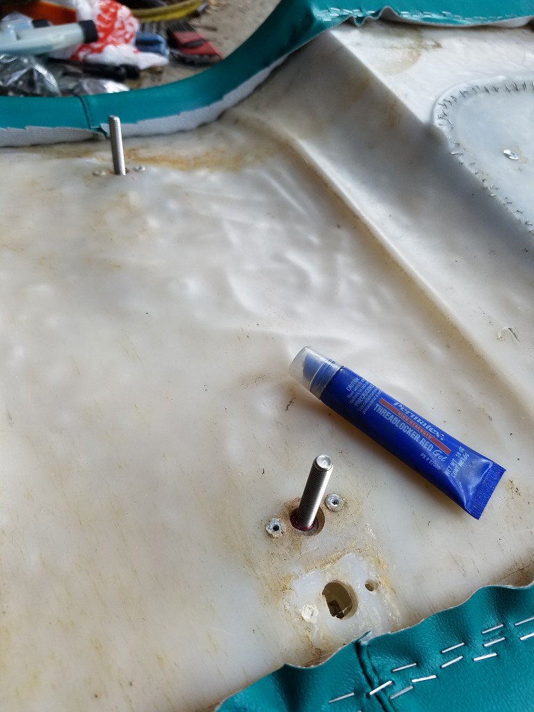

I took some steps to make this seat a LOT easier to install and remove. I added studs! I went to the hardware store and bought 4 new metric stainless bolts about 2" long. I cut off the heads with my band saw, I then fouled the threads about 1/4" from the end. finally, I used red Locktite to hold the studs from spinning out.
I went with wing nuts and washers. I put tacky grease on the washers to hold them up on the inside of the hull while I install the wing nut. it worked easy as pie.

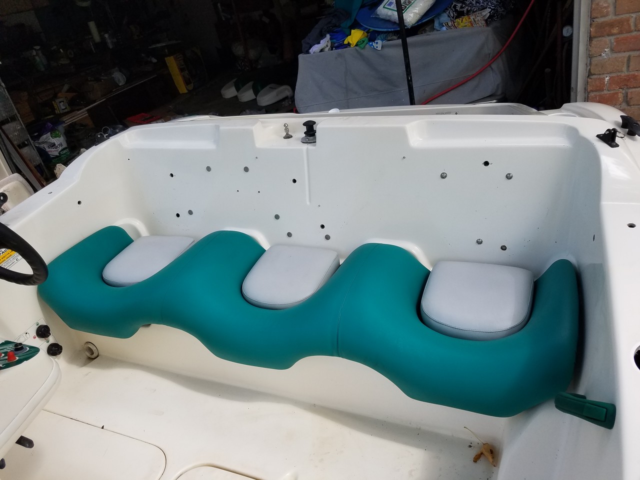

and finally, here is the bottom installed.

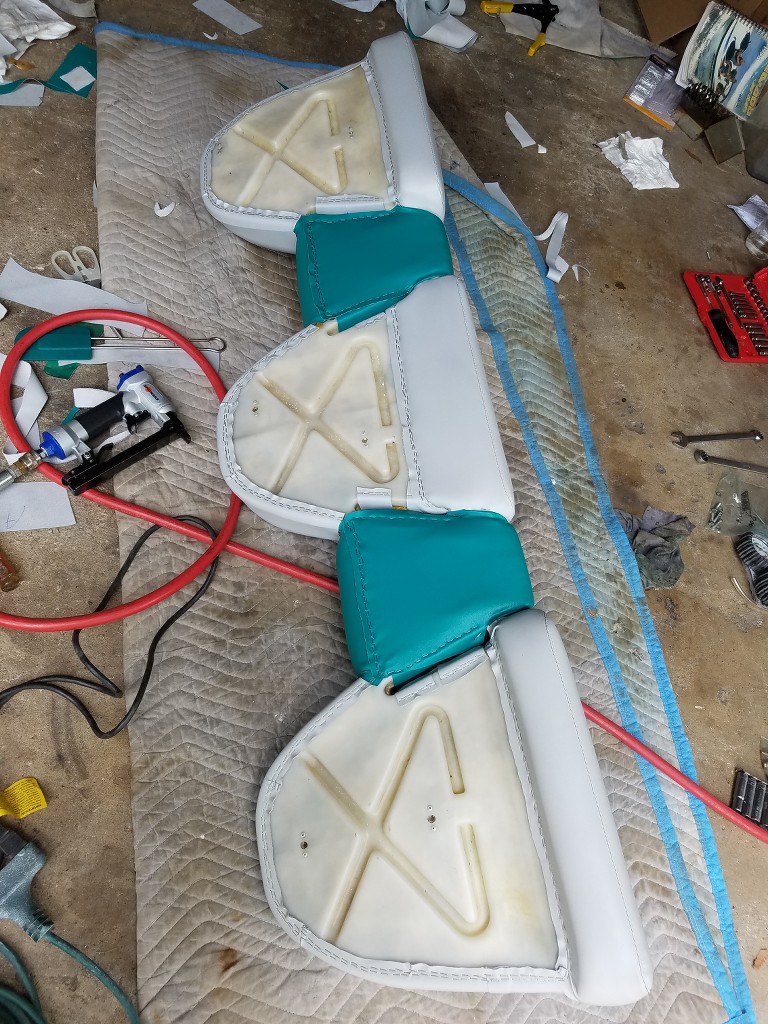

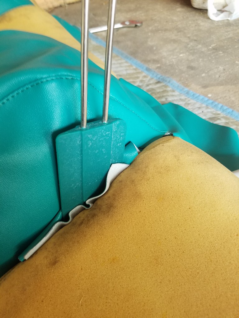

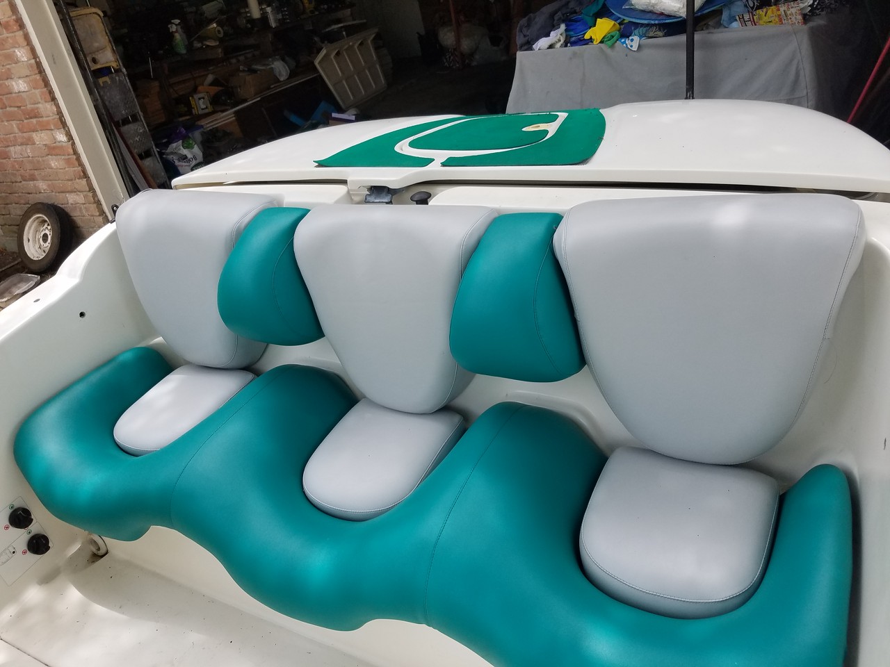

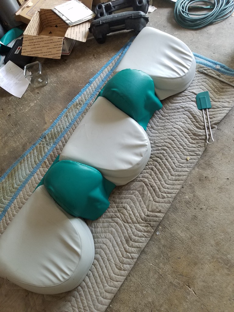

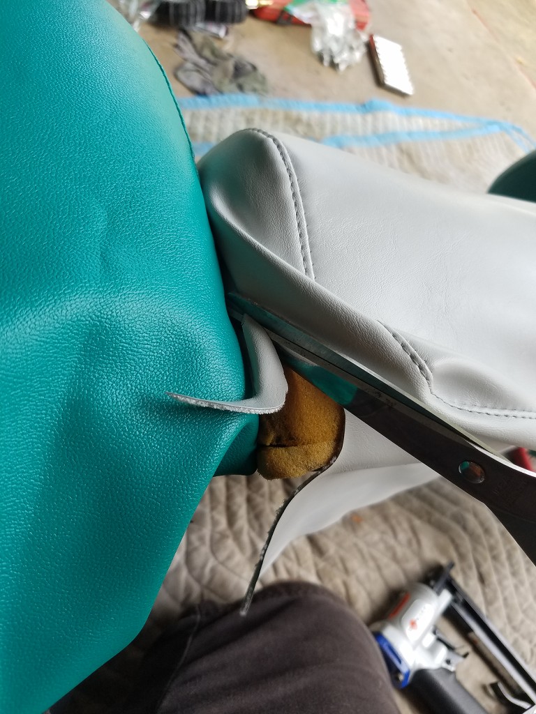

I re-upholstered the top half of my back seat yesterday. pretty happy with how it turned out. I sent pics to Keith and he was ecstatic.
if you have done this re-upholstery job or have the kit, you will know what I'm talking about here. you need to push these fabric tabs through a slot to get them through to the back of the seat. I found the best product for the job was this silicone kitchen spatula. sometimes the tab will get jammed behind the plastic. just pull it back out and try again.
I found that there was a little bit too much fabric in this area. I had to trim a little off so that it would pull down properly. be careful and go slow here. you don't want to take off too much or it will show.
I suggest pulling all the pieces over the foam before you staple anything. try to get them situated as best you can. in order to install this upholstery kit properly, you WILL need a heat gun. I used it (A LOT) in the horseshoe area of the seat bottom and I used it on the two green "boobs" on the seat back. the temperature here in east Texas is well over 90 degrees right now and its just not enough to get the wrinkles out by itself.
this is a pic of the rear side after completion. I trimmed up the excess and I think it looks pretty professional. I purchased that nail gun new specifically for this job. I have to say it is a dirty piece of crap. If you have the opportunity to buy another brand, I would do so. I had to oil it constantly to keep it from misfiring staples. once the magazine gets down to about 15 or 20, it shoots blanks, apparently because the spring isn't strong enough to push the staples into the hammer. the hammer will jam in the downward position after about 100 staples or so. I had to keep a can of silicone spray handy to lube the hammer area from inside the magazine every time I reloaded staples. total Chinese crap I say!
speaking of staples, the only box of 3/8" stainless staples I could find was 5000 pieces. as a result, I double row stapled everything. since I don't have an old Korean lady as my sweatshop boss yelling things like: "you use too many staple!", I figured I would go hog wild. I don't know how this vinyl compares to the factory material, but I assume it is perhaps not as robust. it seemed like a good idea to use extra fasteners since I have 3x more than I need anyway. better safe than sorry.
and finally, here it is installed with the seat bottom. I am pretty happy with how it looks. as I mentioned above, I had never done upholstery work before, but I am very mechanically inclined, persistent, and like to put a lot of effort into doing a good job.
a few notes about the kit: it was not easy to install. on a scale of 10, I would say the difficulty level is probably about 8+. Keith did a really good job making the parts. I can tell he put tons of thought into it and probably has re-engineered the pieces many times. however, the factory fabric was pre shaped in some sort of heat press. particularly the green vinyl for the seat bottom. without investing thousands of dollars in equipment, there is just no way to reproduce this perfectly. the truth is, you can have results that look like mine but its going to take a LOT of hard work. if you don't think you have the fortitude to make it look right, I would still buy the kit, but take it to an upholstery shop for installation.

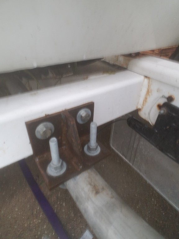

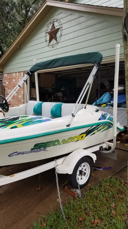

so...ive been working on the boat in my spare time. I've made a few improvements here and there.
notably, I added a Bimini. the boat would have had factory one originally. the mounts are all there. this one came from Amazon and cost about 150.00 shipped. not that the factory version is still available, but it was a fraction of the cost. I had to make a few modifications in order to make it fit. we are very happy with it though.

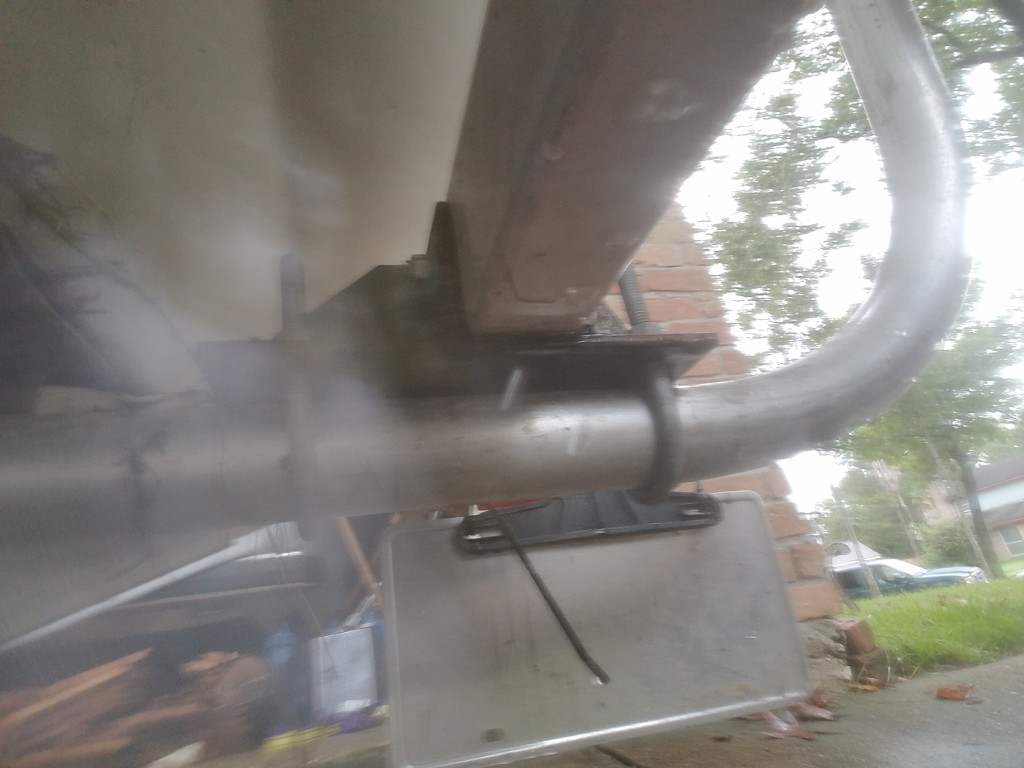

also in this photo, you can see that I added those corner markers to the trailer. they have been laying around in my storage shed for years. I finally have a suitable project to install them on.
I had to fab up my own brackets to fit the trailer. sorry the pictures are poor. it was raining today when I took these. I was having a really hard time keeping drops off my phone when I took these.

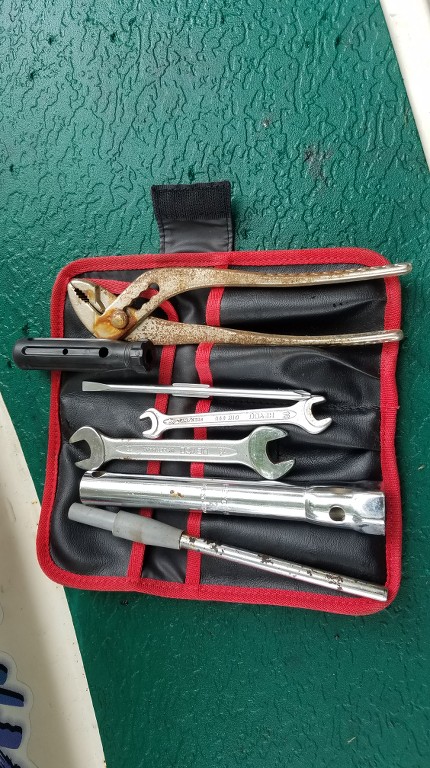

I put together a took kit for the boat fashioned from my parts stash of OEM BMW factory tools. I still need to add a small brass cleaning brush for cleaning spark plugs. if anyone can think of anything else to add please speak up.

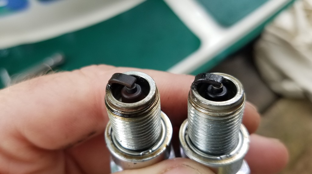

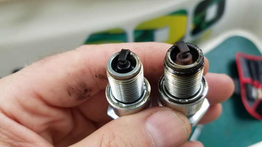

speaking of plugs, we have ran the boat for perhaps 3 or 4 hours. mostly at 4500-6000rpm. the one that is a little brown is from the magneto side of the engine. this one is the starboard side.
this is the port engine, the browner plug is also the mag side.
the reason I posted these is because I was thinking about leaning out the mixture a little. what are your thoughts? I've noticed that if we have been out running the boat for a while and turn off the engines, they don't start particularly well. they will sometimes stall if I don't raise the throttles up a little.

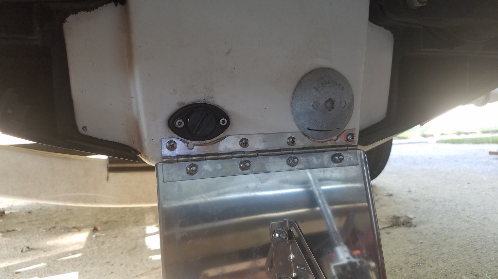

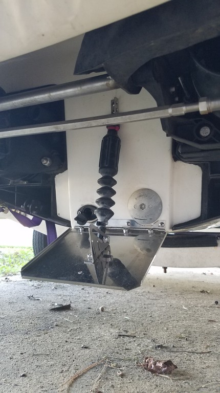

I just ordered a set of nauticus 980 trim tabs with the 40lb spring. I plan to use one in the center. I will post up pics and results when it arrives and we get the chance to put the boat in. I will probably be selling the other if anyone is interested.

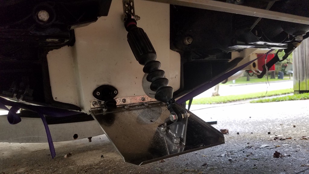

trim tab came in the mail yesterday afternoon. I did a quick install and we promptly trailered to the lake to try it out.

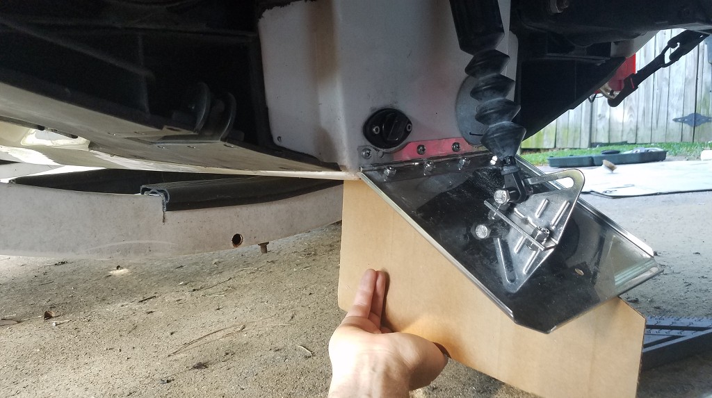

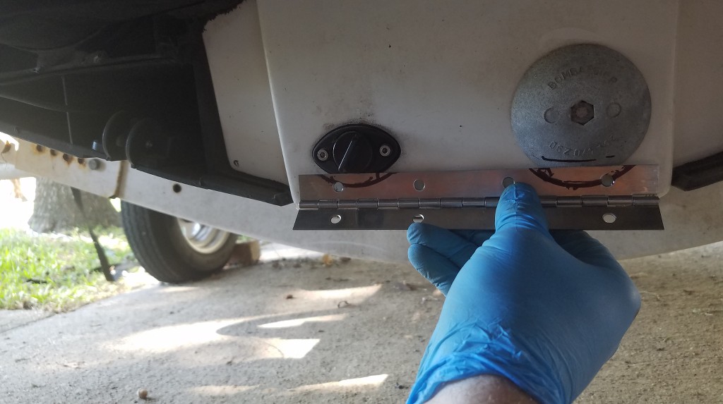

install was easy peasy! the first step was to use an angle grinder to remove the portion of the hinge that interfered with the drain plug and zinc.
I had to move the outboard screw in each side as you can see. the metallurgy in the hinge is pretty soft and fairly easy to work.
the directions allude that the box has a 25 degree template built in that you can cut out and use to mount the shock. they are full of crap so I made my own from a piece of thick cardboard I had laying around.
this one is me trying to hold up the template and tab while snapping a photo.
and finally, the completed installation.
I had to modify the upper mount a little because the actuator eye is too close to the bracket flange. there is no room for the lower screw to fit in there as it is made. also, it has 3 position adjustments but it is only possible to use the lower one in this installation. I think I will probably remake the top bracket at some point.
I think it is well worth it to spend the extra money for the stainless tab. there is a lot of value in not having to move the plug and zinc. no extra holes in the transom of my boat. I called Nauticus directly and this is the tab size they suggested with a 40lb shock. they were willing to ship a single tab directly from the factory for 99.00 plus shipping. I didn't ask what the cost of shipping was, but I assume about 15.00 or so. I found a pair on eBay for 125.00 with free shipping. unfortunately, those shitheads charged another 10 bucks for "tax" even though the item came from another state. this extra kind of irritated me because I had no idea I was being charged this amount until after I committed to the "buy it now" so I was kind of stuck. I think its probably just a way to hide extra cost for item without calling it "shipping or handling" or whatever.
My notes after use:
there is a marked improvement in the ride. the lake was pretty choppy yesterday. the bow stays low and it seems to glide over the top of the waves and feel much more stable with much less bouncing around. the boat comes on plane faster than before and I would say the bow runs lower at all speeds. I still have that
"no man's land" regime between trolling around and getting on plane but I would say it is narrowed to about 1000 (or perhaps 1500 rpm) instead of 2000 rpm that it was before. during that wallowing mode, the bow also runs much lower than it was previously.
The singe tab DOES make reverse slightly less effective. it still works though. its just not quite like it was before.
As to top speed, I don't know. the lake was a bit choppy yesterday and we had the Bimini up. I saw a little better than 40mph once at 7k rpm, but I didn't run at that speed for more than a few seconds.
keep in mind this stainless tab(9x8") is 2 inches shorter than the plastic(9x10"). just for experimentation, I am planning to buy a piece of 3x9" stainless to add to the back of the tab to see if it further changes my ride in any positive way. also, I presently have the shock adjusted to the furthest forward position. I think the tab will be more effective if I move the lower bracket to the furthest aft position and move the shock as far back in the slot as possible. unfortunately, this will mean that I will have to re drill the holes in the transom for the upper mount.

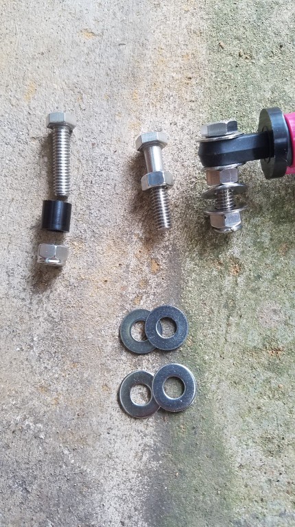

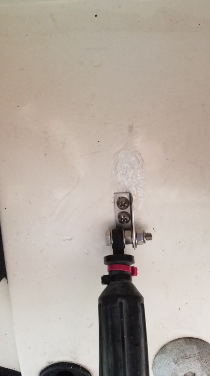

I made some adjustments today. I spent some time doing a wood working project and in between the time I was waiting for stain to dry, I decided to fill it with some improvements I came up with after sleeping on it last night.
first of all, I made a trip to the hardware store to buy a couple different bolts than were provided. the fully threaded shank bolt on the left along with the fiber lock nut and plastic spacer are what was provided with the kit. first of all, the bolt is too short. with the spacer and the shock installed, you cannot get the fiber lock nut threaded on the bolt far enough lock the nut on the shank. since the shock end is plastic and the spacer is also plastic, you are basically screwed. if you really torque it down, you are going to deform either the spacer or the shock end. also, the end won't be able to rotate. if only moderately tight, the fiber nut will work itself loose in a short time.
the bolt in the middle and the one on the right are 5/16" shank shouldered stainless bolts that came from the local hardware store. I also purchased an extra nut and 4 washers for each fastener. it seems like the plastic shock eye will last a lot longer riding on the smooth shouldered part of the bolt rather than the threads of the bolt provided.
this picture illustrates 3 things: first, the new hardware is installed so the bolt is tight on the bracket but still allowing the shock absorber eye to rotate. second, I had to "custom" drill the hole for the lower screw in order to install 2 in that mounting bracket. as alluded to above, there simply is no clearance to install that lower screw and the strut together. third, you can see that I had to re drill the holes I made in the transom to compensate for the adjustments I made to the tab settings. I elected to use marine epoxy to fill the holes after roughing the area up with a little 100 grit sandpaper. I don't know if it will hold but it seems to be stuck on there pretty good. my next course of action will be fiberglass resin if this doesn't work.
finally, here is everything re-installed with the new shock setting. it seems to take a good deal more force to lift up the tab in this position.
I won't be able to try it out until next week assuming the weather is good. I will be out of town for a few days starting tomorrow.
brian
I wanted to post a quick update about the tab. after the adjustments above, a buddy and I had the boat out on the water today. we spent about 2.5 hours motoring around at all sorts of speeds and regimes. Both of us combined weighed about 400lbs and we had a full tank of gas. we were in the back of the boat the entire time. (as a comparison, my wife and I are a combined total weight of about 300)
moving the strut to the far back adjustment made a huge difference in a positive way on all accounts. I can say that I am not going to bother adding a couple inches of metal to the back of the tab. it is so effective now that there simply is no reason to bother. I might almost say it is providing a little too much force at wide open throttle. perhaps the bow is now a little too low in this regime? my "no man's land" region of bow rise is perhaps narrowed to about 500 rpm. around 3500-4000 or so. the lake was fairly glassy today, so I can't really speak as to the ride in choppy water with the latest adjustment.
I can now say this accessory really was a fantastic addition and worth every penny. I might go so far as to say that the improvements have spoiled me to the point of not wanting to drive a boat like this without it.
