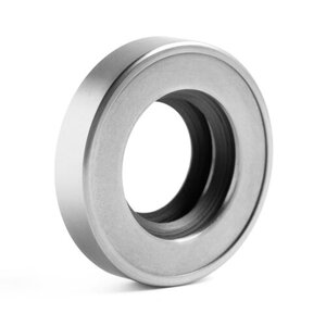

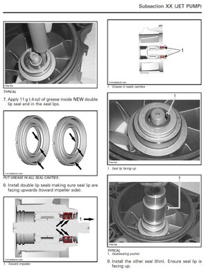

Just replaced my jet pump bearing for the first time and all the seals. The dealer said one of my part numbers (oil seal) super seeded to a newer part number. This one looks entirely different than mine. I’ll attach photos of my old one vs new. My old one didn’t have an open side but the new one does. Which way is the right way of does it not matter which way the open part faces?

Ok. I did what digdog said. So that’s wrong. I’ll have to change it to what jakgal04 said. What happens if you do it the way I did? I noticed my carbon seal/ring is vibrating like crazy but this can’t be because of flipping that seal right?
I'm not sure how much of an impact it would have in terms of water sealing, but it certainly shouldn't impact your carbon seal.
