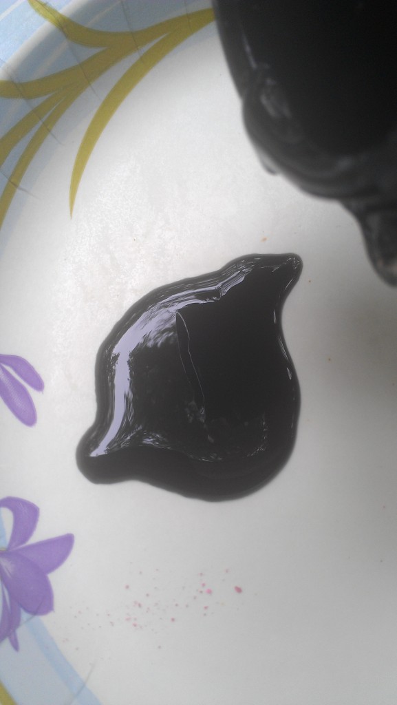

For an oil change.
The jet pump oil was in dire need of replacement. No white stuff present, only jet black oil. But, it stunk to high heaven. I replaced the oil with the jet pump grease.
It stinks because it's gear lube. (Full of sulfur) What kind of ski/boat is it?? If you took oil out... DO NOT PUT GREASE IN IT !!
98 sportster. The people at the parts place told me I could put the grease in. I have to take the pump off anyways. So, I guess I'll be cleaning grease out today?????
F'ing idiots !!!! (not you... the guy at the parts store)
Yes... you need to remove all the grease, and put in synthetic 75w90 gear lube. The older pump uses small roller bearings, and they need oil to work. The newer pumps have a lot more room inside, and are designed for grease.

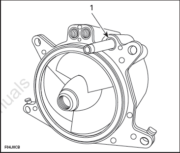

I had the pump in the vice (not securely) and the piece that extends out from the pump broke. The piece broke off at the base. I put some epoxy on it hoping it will hold. After looking at pictures online, it looks like this piece is supposed to come off... Any guidance here?
It does unscrew from the hole. I used a flat head screw driver to jam in there and unscrew it. Most people RTV them in there and it hard to see the threads...
Yep... it's removable.
