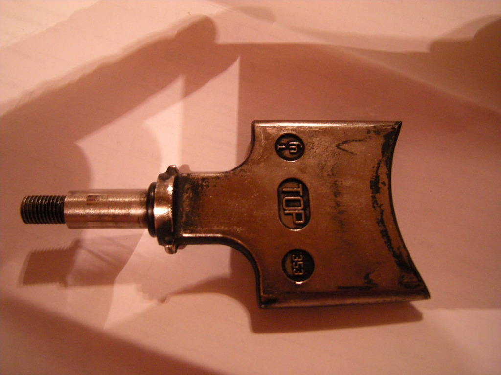

Thanks guys. Are there any other identifying marks to help confirm (one last cross check), say on the other side?  My other side is totally clean, no markings at all anywhere.
Unfortunately it (this new valve, pictured) is way too loose (as evident by guillotine impact damage and two melted RAVE pistons).
The guillotine in the pic has only about 4 hours of run time (and it is pretty decent shape) the other was beat up pretty good.
Tried the SBT oversize guillotine, but it will not fit (just a bit too thick).
These OEM measure 0.312" thick, the SBT oversize measure 0.335".  SBT measured several of there standard guillotines for me today and they are 0.322".
Suprised there is such of difference.  By chance do any of you know the thickness of a true OEM guillotine for comparison?
I would expect the stock OEM and standard SBT to be the same.
