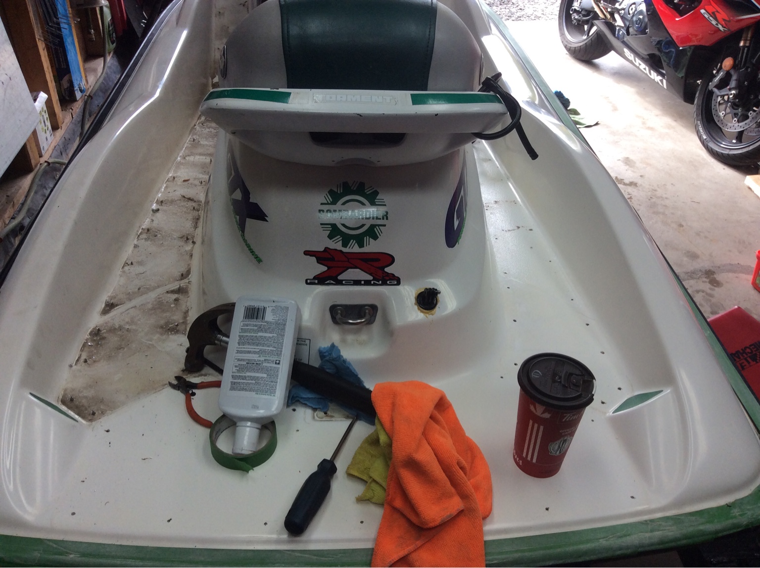

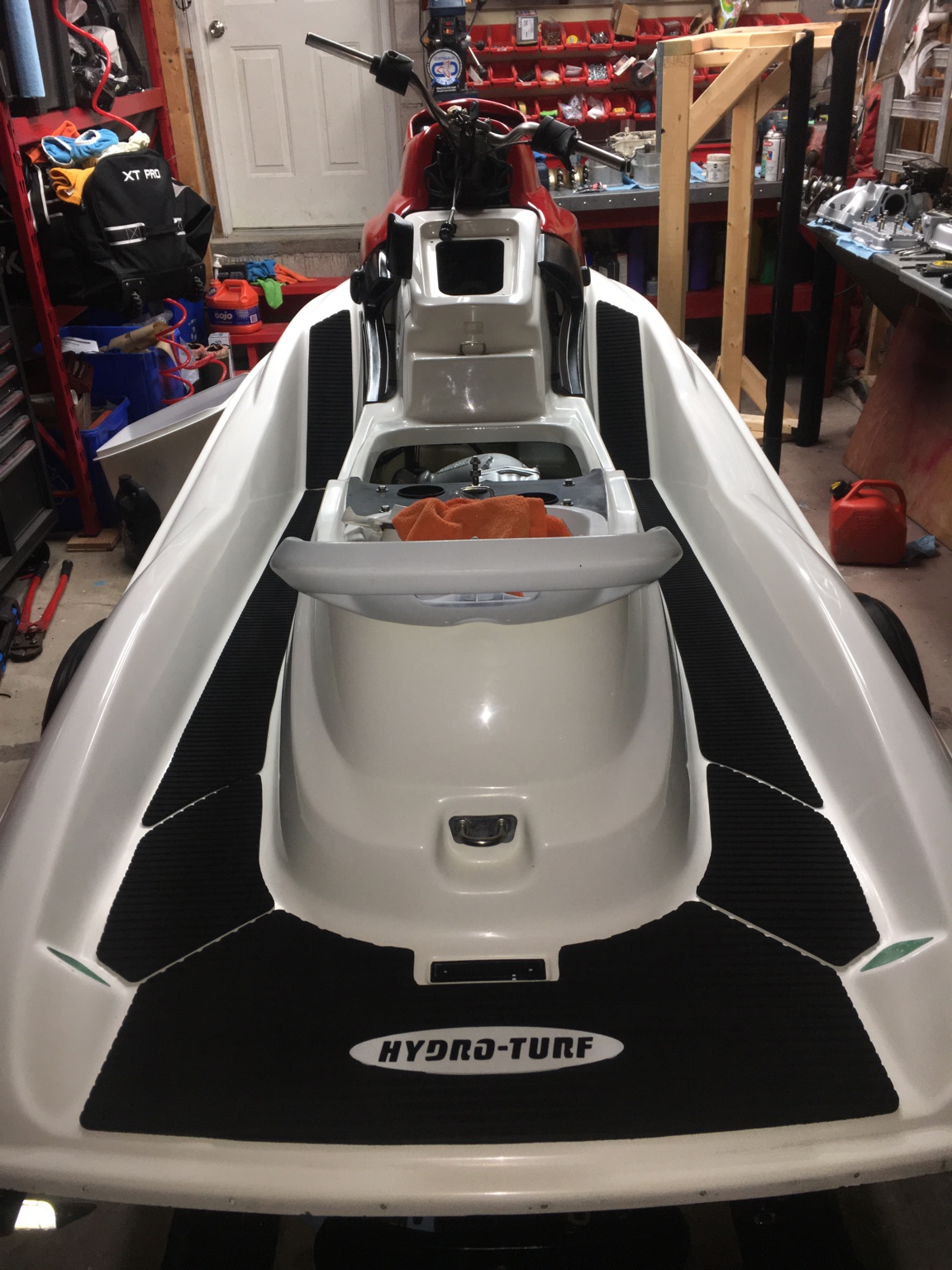

A lot of guys like two part epoxy. Silicone would be better then nothing though. I use Weldwood contact cement to bond the mats.
They did not used to have mats like that but perhaps they do now. I have not ordered a set from them in a couple years. Please share pics when yours come in.
Nothing will stick to silicone. I would suggest the marine Bondo from Walmart. It won’t absorb water like regular Bondo and when it starts to gel you can scrape off the excess and don’t have to sand it.
I used marine Tex myself, overkill and word to the wise, don't use a bunch or you will have some rock hard lumps that are a major PITA to sand down to deal with, just a dab and before it dries you want to use a putty knife or similar to flatten it out. I learned that the hard way.
I don't recommend silicone because nothing sticks to it.
And yes, they should come with 3m sticky and it sticks quite well, after doing many in the past with weldwood, which made a bit of a mess if you aren't careful, I really enjoy the 3m mats.

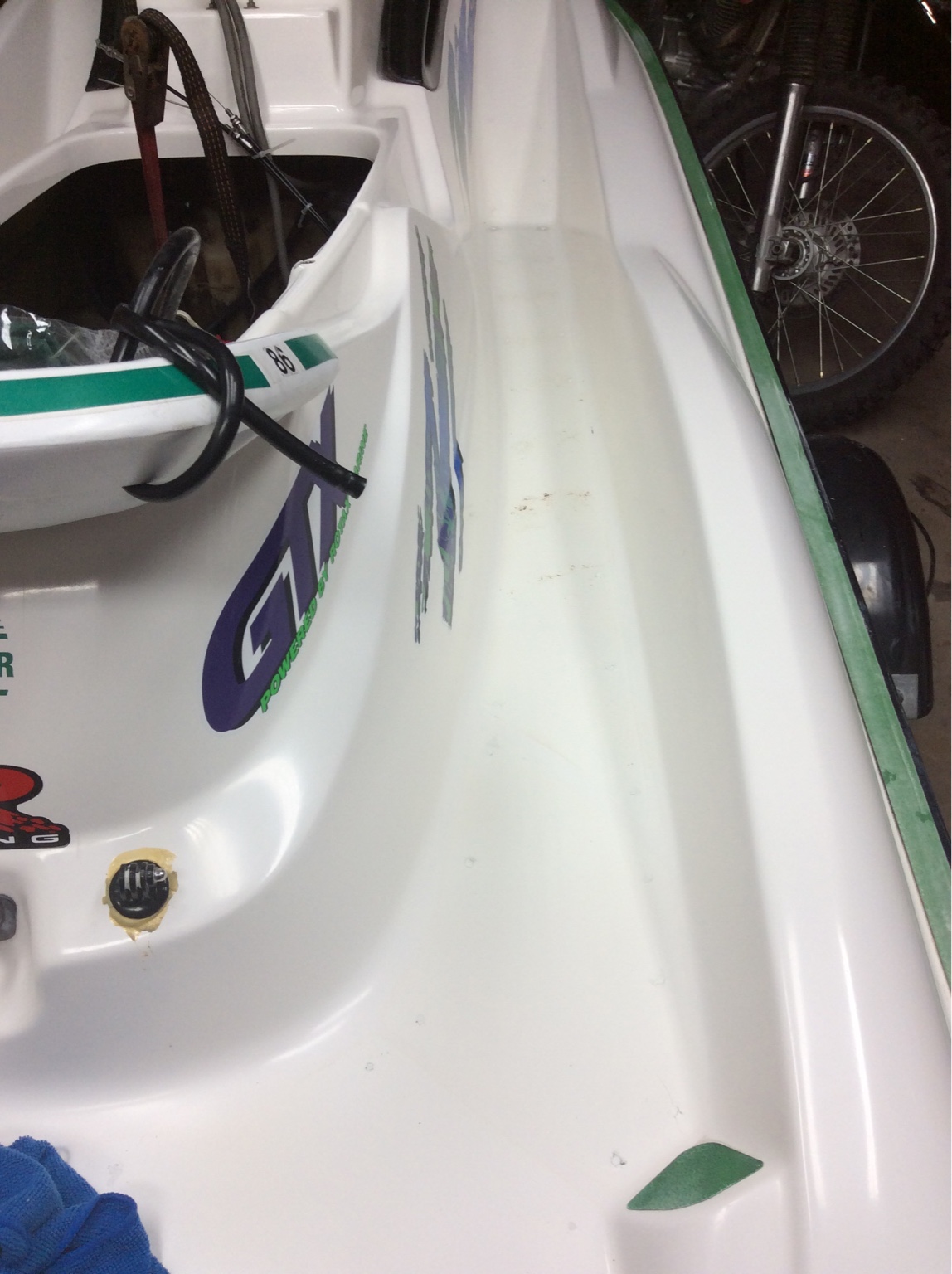

Justin, the job you did looks great. Today I pulled off all the warped factory plastic ones on my 97 gtx. Got to take care of the rivets and holes and then I will decide on color and style. Has anyone checked with a local carpet company to see if they would have anything that will work.
