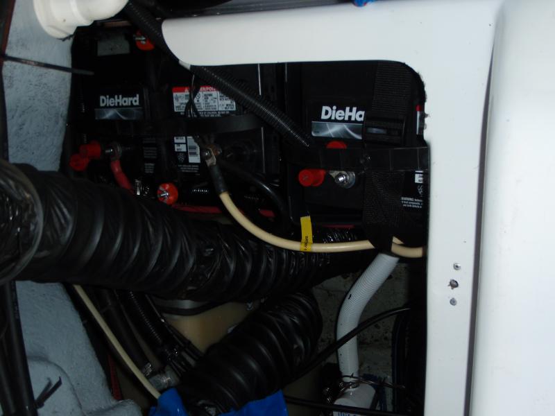

I'm upgrading the stereo on my 97 sportster 1800, twin 717s. It will include 4 speakers running at 60rms max, as well as a subwoofer running at 175rms max, + anything else. I've decided to add a second battery in case I drain one sitting with the music playing, etc.
I've purchased the BlueSea add-a-battery. It should charge the starter battery initially then when full switch to the charge house battery. When the house battery drains it will not affect the starter battery's charge.
What combo should I use? A smaller marine starting battery, and a deep cycle battery for the house? Can the 717 charging system successfully even charge a larger deep cycle battery? Currently there is a dual-purpose interstate battery on the boat.
