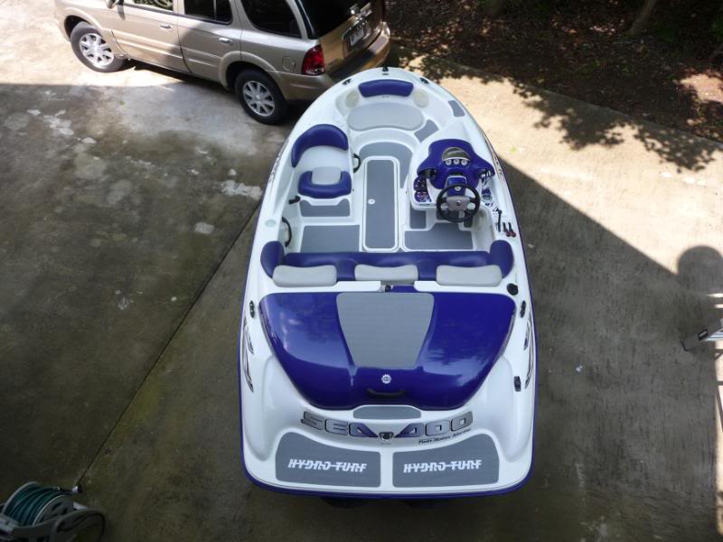

The 3M is the same stuff I have had on the back of my surfboard grip for years. Yes, with lots of use, it may start to peel up, but regular use shouldn't affect it for many years.

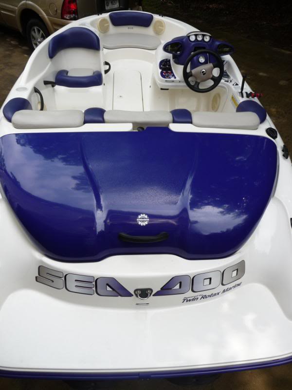

It took us about 2-1/2 hours to get the swim platform clean, because it has that rough area made into the gelcoat. The hatch only took me an hour because the glue comes off the smooth areas much easier. Be careful with the razor scraper on the smooth areas as it will scratch the gel.
I didn't care if I knocked some of the gel off the bumps on my gel at the swim platform, but honestly, not much was damaged.
