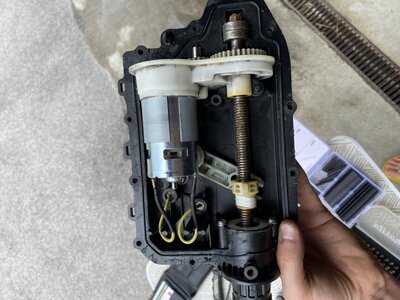

Hello everyone,
I have recently found out that my ibr does not work, after some disassembly I found that it was flooded.
I ordered the new parts and put it together, only the electric motor suffered damage, which I replaced.
My question is in what position should the plastic, that attaches to the outside shaft, be in? ( the one with the teflon tape )
I have vts but the motor was removed due to issues.
It is a 2016 model year
Thank you
[SOLVED] it is automatic, just put it in what every position and the computer will align when pressing gas and brake
This is here for future reference
