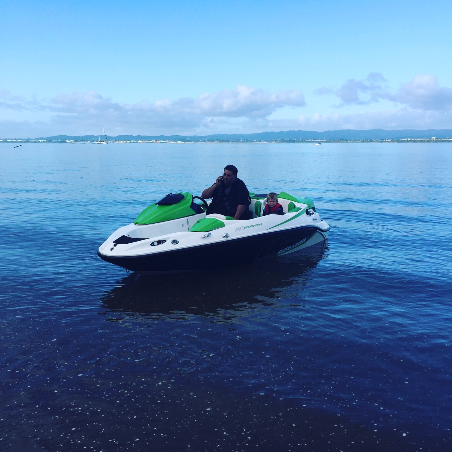

Hi, I have the same boat
The local seadoo dealer pulled mine out and said it is a 12/21 in the pitch gauge. We have replaced with a 14/18 Skat three blade and the boat is so much better.
As a matter of interest what is your top speed?
I'm weighted down with the wake tower, etc.... so it's been right at 57 mph and shot out of the hole like a rocket.
