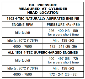

Revised- If the supercharger did fail and leave pieces in the engine, not sure how long before it will effect the engine operation. There are two oil pressure ports- one under the intake with the oil pressure sensor in it. Another on the back of the head which you could connect a gauge to. The normal expected pressure for the head port is below.
