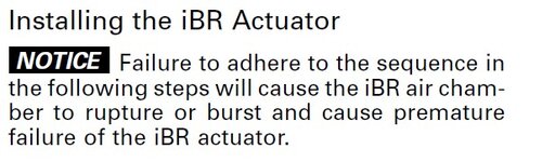

I've recently had my IBR actuator motor replaced and I've lost 20km off top speed since then. It appears as though the IBR bucket has been set up incorrectly. Bottom of the bucket is 200mm below guard when adjusted completely up. Anyone got a manual for adjusting this or is it something that needs to be adjusted via buds calibration? 2020 Seadoo 230.
