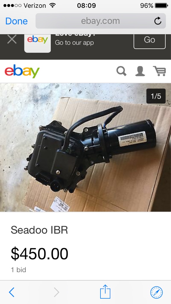

[MENTION=86524]jake04[/MENTION]. On eBay right now. Item Number. 182288795349
