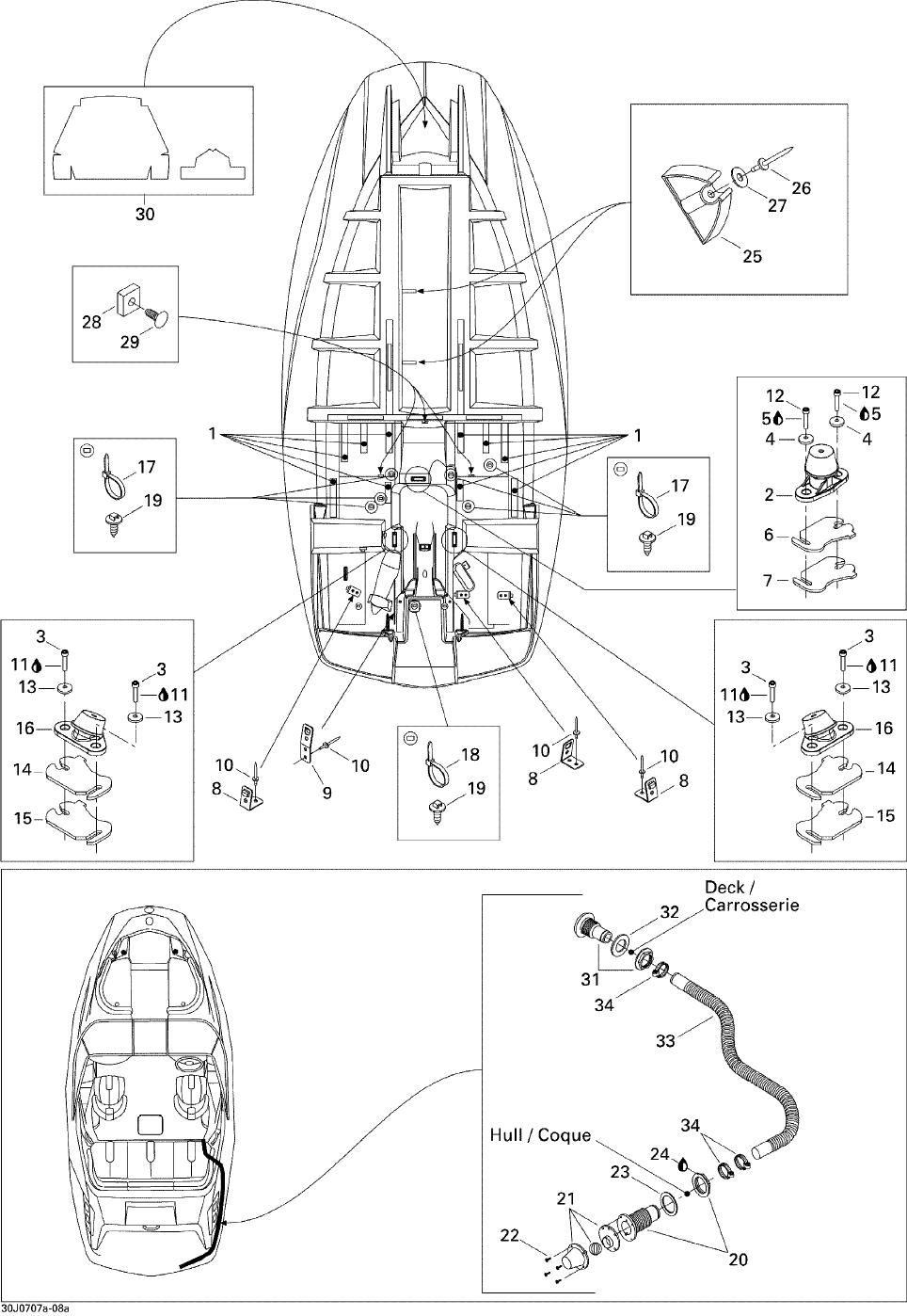

Your deck drain should be direct to the scupper valve on the back of the boat (see diagram--lower right), and I'm sure if you could tie the cooler drains into the deck drain that would solve a good bit of that. Not sure who would disconnect that.
Nice....thanks....yea it's gone... It just poors right on my gas tank....I use my boat about 3 times a week...I'm in salt water so I wash it every time...that adds up to a lot of water pooring in there...
Thanks for that diagram...going to seadoo dealer and see if I can get that...or find a universal part...

I can't say if this is the correct size but this is what you're looking for. It's cheaper on Amazon but for some reason SDF starred out the links. Again--you need to verify the correct diameter. This was just given as a visual.
http://www.ebay.com/itm/NEW-Watts-S...e-and-Pump-Discharge-Hose-White-/371021018358
You could probably pull the scupper or get part#'s off it and back into the fitting size.
Thanks for the help but I just called the local seadoo dealer and they have a 2006 challenger there that the owner is parting out do to it sinking at dock...mine is a 07 but should work....shouldn't be bad from sinking it's all plastic....said $5 for it if its there and I pull it...do I'm going up there around lunch...
