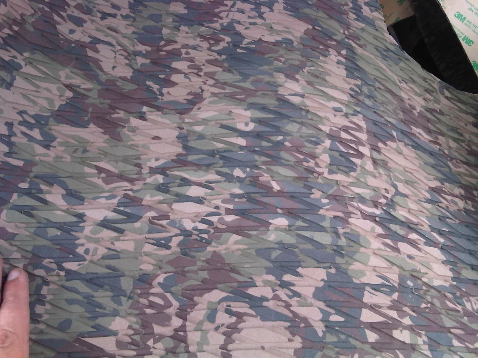

swamp camo turf set arrived today and WOAH doesnt it look diffrent to whats on the website. Unconvinced this will look good in a blue boat. should match the tan on the interior vynil but hmmmmmm. Was expecting Grey/Blue shades. Will see how it looks when/if it goes in.
Wow!
Definitely a red to tone through the colour. Would look good in the red boat, not sure with the blue. The website patch looks like a bluish grey base tone.
Good luck, hope It looks great
Cheers
I see more tan brown etc I reckon a black boat it would go best with. I would have liked the grayish tone as seen on the website! I hope it looks great too however we will need to wait and see. Have recommended to hydroturf to update their website so this doesn't happen to the next monkey.

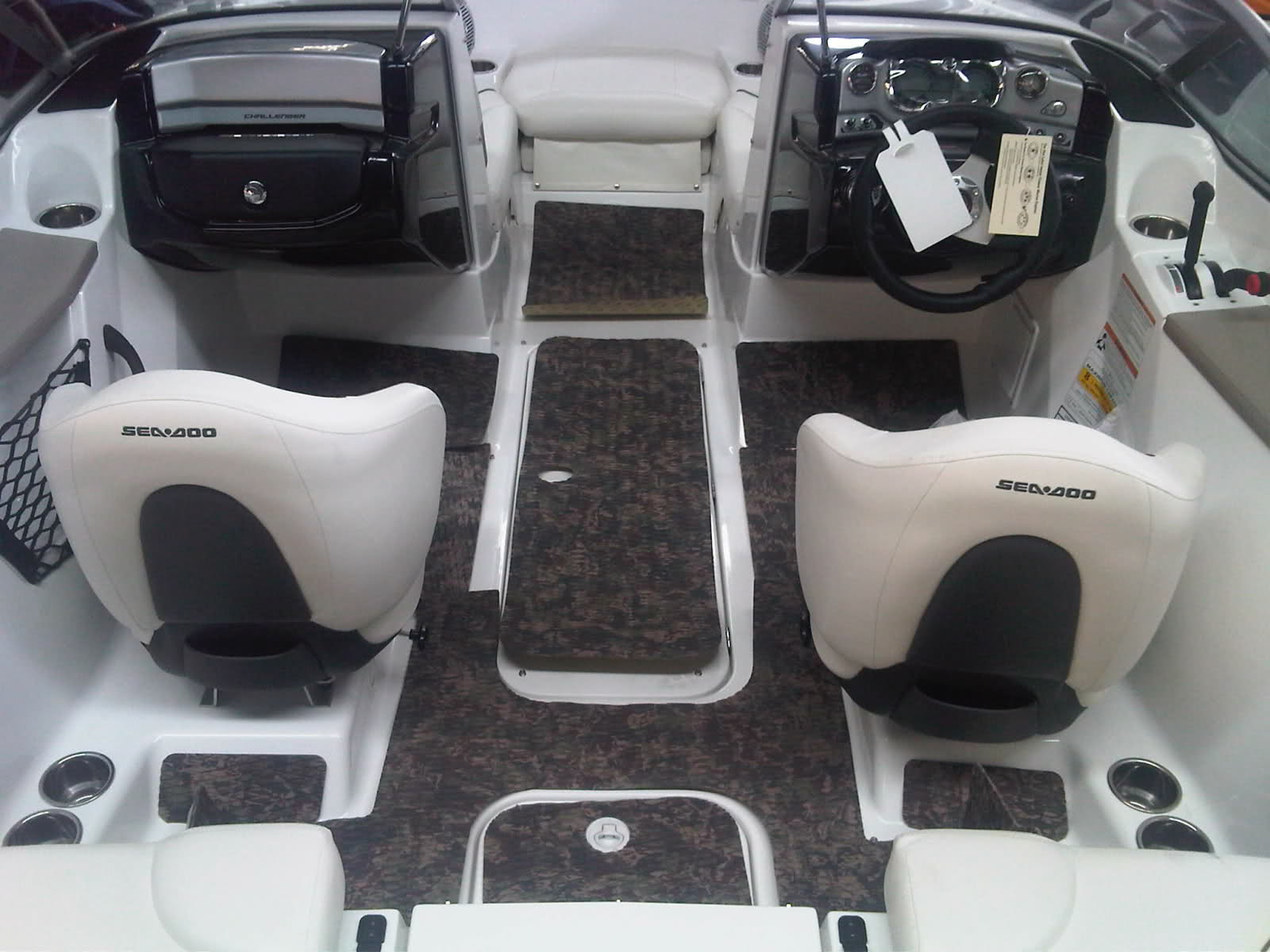

Ok So managed to find some time to get down to the dealer today and laid out some pieces in the boat.
In my opinion the swamp camo goes great inside the boat. Is dark enough to hide a bit of dirt and the tan element works in well with the tan on the vynil aphulstory.
Where it looks very average is on the loading platform as the blue and camo colors do not work well together. Have got an email off to hydroturf to see if theres anything they can do for me regarding the inconcistency between colors on their website and real life.
I like it a lot! The reason I went for granite was the break up of colour adds a quality look to the foam. Yours definitely has that look. Very nice.

Thanks Davo, Im thinking those two neopreme pads up around the helm could be changed out to camo as well. Theres definetly alot of black in the 2011 models and up which work well with the swamp camo color.
I definetly want a light greyish color for the swim platform. Granite was actually my first choice but alas it is now discontinued.
Ok so just got off the phone to Megan at hydroturf, They are happy to swap out the rear platform to grey in cut diamond.
