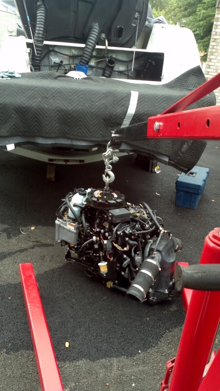

Does anyone know of a video or instructions on how to REMOVE the engine? There's not enough room to be able to lift the motor straight up. And OF COURSE #5 is under the deck.

As far as getting the engine out... it will lift straight up. (at least 4~6 inches) It has to, since the driveshaft comes out of the pump, and slips into the crankshaft. If you pull it sideways... you will bend the shaft.
Also... it's a heavy engine, and you need a lifting eye, and an engine hoist, or A-frame to pull on. It's WAY too heavy, and awkward to try to lift it by hand. (even with 2 or 3 guys)

It doesn't appear to be 6 inches of clearance.
